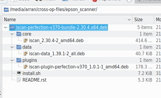

          The location is correct.
          The attachment shows what I have.
          I still keep getting the message «No such file or directory».

            Let's see the contents of the install.sh file please.
            Slava Ukraini! 🇺🇦
              Actually, it runs fine. It's already executable and all.
              ~/Downloads/iscan-perfection-v370-bundle-2.30.4.x64.deb$ ./install.sh --dry-run
              apt-get update
              apt-get install --assume-yes libsane xsltproc
              dpkg --install ./core/iscan_2.30.4-2_amd64.deb ./data/iscan-data_1.39.1-2_all.deb ./plugins/iscan-plugin-perfection-v370_1.0.1-1_amd64.deb
              What I suggest trying is right-clicking on iscan-perfection-v370-bundle-2.30.4.x64.deb.tar.gz and choosing Extract, Extract archive here, autodetect subfolders.
              Then moving into the extracted folder, opening the terminal (F4) and ./install.sh

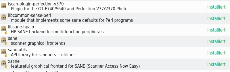

                After several trials I managed to get a part-Installtion. Discover tells me Installed, same as Muon and Synaptic.

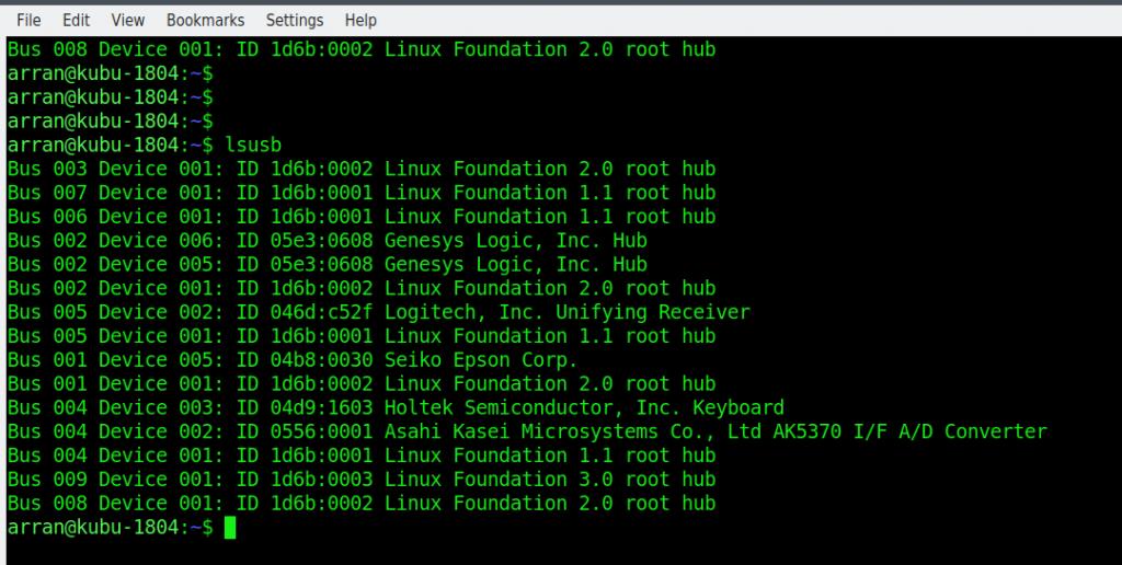

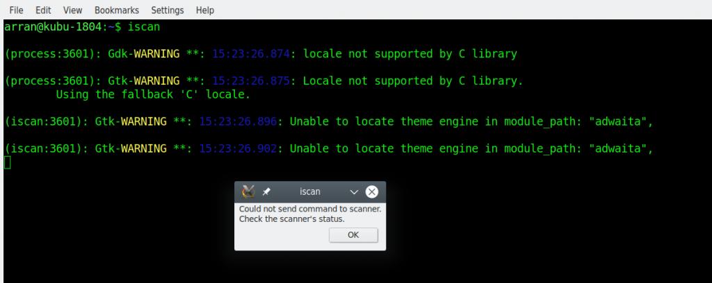

                However, when I want to start via the console I get a fatal error, see attachment I then made as lsusb and really, I can only find my printer from Epson.
                I had the cable in 3 different usb's the result is always identical. When I put the USB into its slot, scanner with green light, I do hear from the scanner a very short sound. I have also checked 2 cables, both run perfect with the Printer but not with the scanner.
                I do hope you know a solution.

                    try installing "xsane" , I had a printer/scanner that had a linux scan app that would not work but xsane would after the manufacture bundle was installed , and conversely the manufacture app started working after xsane got installed .
                    worth a try .
                      Hi Vinnywright
                      xsane is already installed. So it must have another reason I can not use the scanner.
