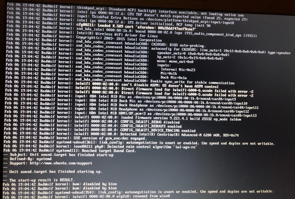

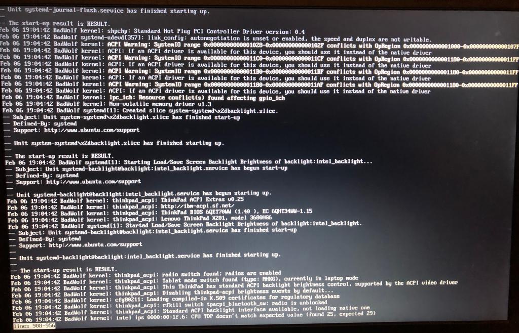

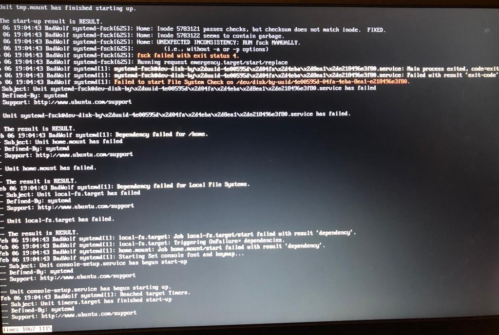

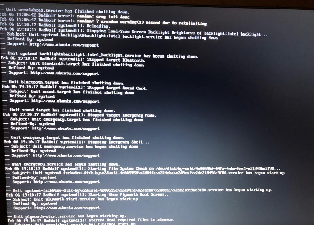

    Here are some screenshots I took with my phone:
    fstab in vi
    Here are shots of my logs:

              Starting at line 1040
              -- The start-up result is RESULT.
              Feb 07 12:15:56 BadWolf kernel: EXT4-fs (sda5): mounted filesystem with ordered data mode. Opts: (null)
              Feb 07 12:15:56 BadWolf systemd-fsck[640]: Home contains a file system with errors, check forced.
              Feb 07 12:15:56 BadWolf systemd-fsck[640]: Home: Inode 5783122 seems to contain garbage.
              Feb 07 12:15:56 BadWolf systemd-fsck[640]: Home: UNEXPECTED INCONSISTENCY; RUN fsck MANUALLY.
              Feb 07 12:15:56 BadWolf systemd-fsck[640]:         (i.e., without -a or -p options)
              Feb 07 12:15:56 BadWolf systemd-fsck[640]: fsck failed with exit status 4.
              Feb 07 12:15:56 BadWolf systemd-fsck[640]: Running request emergency.target/start/replace
              Feb 07 12:15:56 BadWolf systemd[1]: systemd-fsck@dev-disk-by\x2duuid-4e00595d\x2d04fa\x2d4eba\x2d8ea1\x2de218496e3f80.service: Main process exited, code=exited, status=1/FAILURE
              Feb 07 12:15:56 BadWolf systemd[1]: systemd-fsck@dev-disk-by\x2duuid-4e00595d\x2d04fa\x2d4eba\x2d8ea1\x2de218496e3f80.service: Failed with result 'exit-code'.
              Feb 07 12:15:56 BadWolf systemd[1]: Failed to start File System Check on /dev/disk/by-uuid/4e00595d-04fa-4eba-8ea1-e218496e3f80.
              -- Subject: Unit systemd-fsck@dev-disk-by\x2duuid-4e00595d\x2d04fa\x2d4eba\x2d8ea1\x2de218496e3f80.service has failed
              -- Defined-By: systemd
              -- Support: http://www.ubuntu.com/support
              -- Unit systemd-fsck@dev-disk-by\x2duuid-4e00595d\x2d04fa\x2d4eba\x2d8ea1\x2de218496e3f80.service has failed.
              -- The result is RESULT.
              Feb 07 12:15:56 BadWolf systemd[1]: Dependency failed for /home.
              -- Subject: Unit home.mount has failed
              -- Unit home.mount has failed.
              Feb 07 12:15:56 BadWolf systemd[1]: Dependency failed for Local File Systems.
              -- Subject: Unit local-fs.target has failed
              -- Unit local-fs.target has failed.
              Feb 07 12:15:56 BadWolf systemd[1]: local-fs.target: Job local-fs.target/start failed with result 'dependency'.
              Feb 07 12:15:56 BadWolf systemd[1]: local-fs.target: Triggering OnFailure= dependencies.
              Feb 07 12:15:56 BadWolf systemd[1]: home.mount: Job home.mount/start failed with result 'dependency'.
