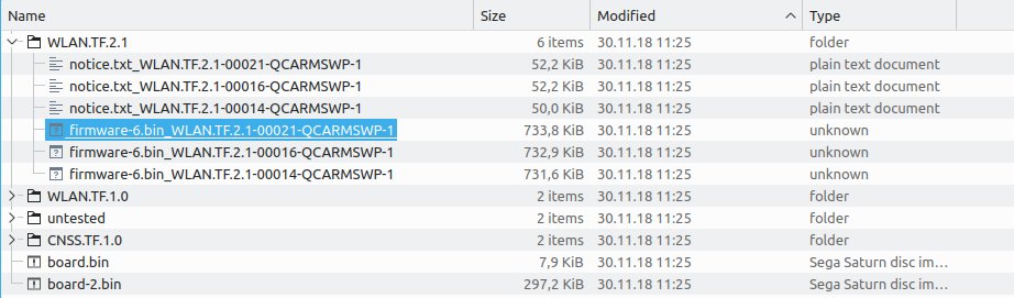

    The Realtech question in the previous thread prompted me to look into an issue I have with my wifes laptop from day one.
    When checking wifi settings I see that tx bitrate is only 6.0 Mbit/s no matter if on 5GHz or 2.4GHz, where my laptop next to it shows 866.7 Mbit/s on the same networks.
    Ran a dmesg | grep Ath which gave me 3 errors regarding files not able to load. One of the three was related to a firmware version 6 not found and when checking /lib/firmware/ath10k... I saw that this directory only contained version 5.
    So I went out searching for v6 and found it here https://wireless.wiki.kernel.org/en/...th10k/firmware
    Copied v6 into the driver folder, reboot and it looks like it was successfully loaded, at least dmesg shows api 6 to be active instead of the previous error.
    5.577456] ath10k_pci 0000:01:00.0: Direct firmware load for ath10k/pre-cal-pci-0000:01:00.0.bin failed with error -2
    [    5.577466] ath10k_pci 0000:01:00.0: Direct firmware load for ath10k/cal-pci-0000:01:00.0.bin failed with error -2
    [    5.578980] ath10k_pci 0000:01:00.0: qca9377 hw1.1 target 0x05020001 chip_id 0x003821ff sub 17aa:0901
    [    5.578982] ath10k_pci 0000:01:00.0: kconfig debug 0 debugfs 1 tracing 1 dfs 0 testmode 0
    [    5.579385] ath10k_pci 0000:01:00.0: firmware ver WLAN.TF.2.1-00021-QCARMSWP-1 api 6 features wowlan,ignore-otp crc32 42e41877
    [    5.644836] ath10k_pci 0000:01:00.0: board_file api 2 bmi_id N/A crc32 8aedfa4a
    So far so good, the other two were not part of the package and the transfer rate did not improve, still 6Mbit/s only
    I couldn't find anything on the other two missing drivers but stumbled over a references to this https://launchpad.net/ubuntu/+source...mware/1.157.21 which I believe us the list of proprietary drivers for Ubuntu? Anyway, the driver in there is the older firmware v5.
    So I wonder what to do next, is the driver story maybe a dead end and I rather need to change a setting? Would booting a live USB OS with a distribution known to use the most recent kernel an option, just to see if something more current gives me a better connection? If so, which one should I go for?
    One more thing I noticed, the driver package I got v6 from had 3 options. I went with the one higlighted, simply because it had the highest number not because I knew what I was doing :-)
    From dmesg and the lshw output below I can see that it was successfully loaded though.
    Also not sure what the TF1.0 and CNSS folders are about, in any case the firmware file in those is v5.

                To prove or disprove my assumption I'll go through these steps now:
                1. try the most recent distro/kernel from a USB drive
                2. Install a windows drive
                3. Return the laptop
                If either 1 or two give good performance I know it's not hardware...
                Update
                I went and followed through my plan above and the results support my assumption:
                Ubuntu 19.04 5GHz 6Mbit/s
                Ubuntu 19.04 2.4GHz 1Mbit/s
                Manjaro 5GHz 6Mbit/s
                Windows 10 5GHz 150Mbit/s
                While 150 Mbit/s isn't great compared to what the others deliver it's sufficient. I installed the Win10 driver from the Lenovo site, just in case but still 150 Mbit/s.
                As far as Linux is concerned I went with the daily build for 19.04 thinking that this is the most recent kernel, turned out what's in this build is older than what I have. Went and downloaded Manjaro and got kernel 4.19.03 but unfortunately also only 6Mbits.
                Well, looks like I bought the wrong laptop :-(

                Final update
                Received a hint to this one:
                tx rate is reported as 6mbps due to firmware limitation (no tx rate information in tx completions); instead see /sys/kernel/debug/ieee80211/phyX/ath10k/fw_stats
                https://wireless.wiki.kernel.org/en/users/drivers/ath10k
                Oops? Went ahead and did an actual test with speedtest-cli and...
                Testing download speed...
                Download: 200.84 Mbit/s
                Testing upload speed...
                Upload: 18.81 Mbit/s
                I feel a little embarrassed as it looks like I was chasing windmills
                My wife was complaining about "slow internet" and when I checked I saw the wrong connection speed and the network manager chart showed very low throughput. But that may have been the internet uplink which was slow for some reason which happens to us every now and then. And then after I found the firmware error messages I was firmly on the wrong track.
                Lesson learned, don't always trust what the system says but measure. Thanks to those who helped me arrive at this conclusion!
