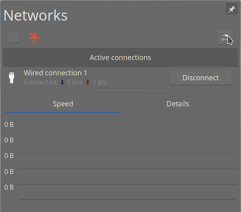

              The tray applet is for all connections. I have set a static ip address on my Kubuntu system:
              Click the icon on the right, as shown near the cursor below

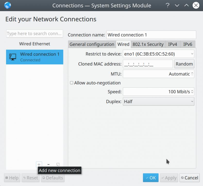

              Click the Plus button if you do not already have a wired connection listed:

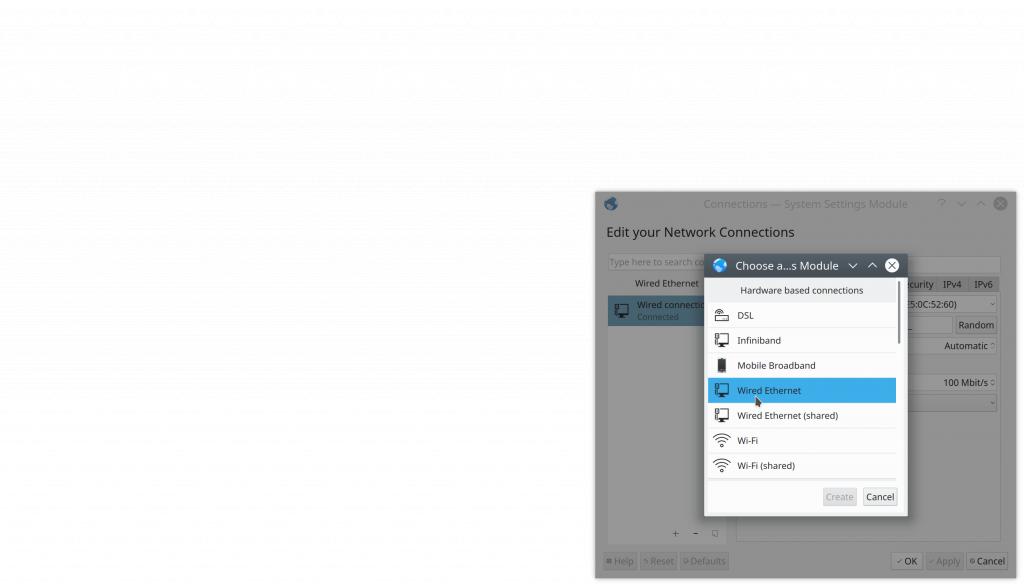

              Select the connection type:

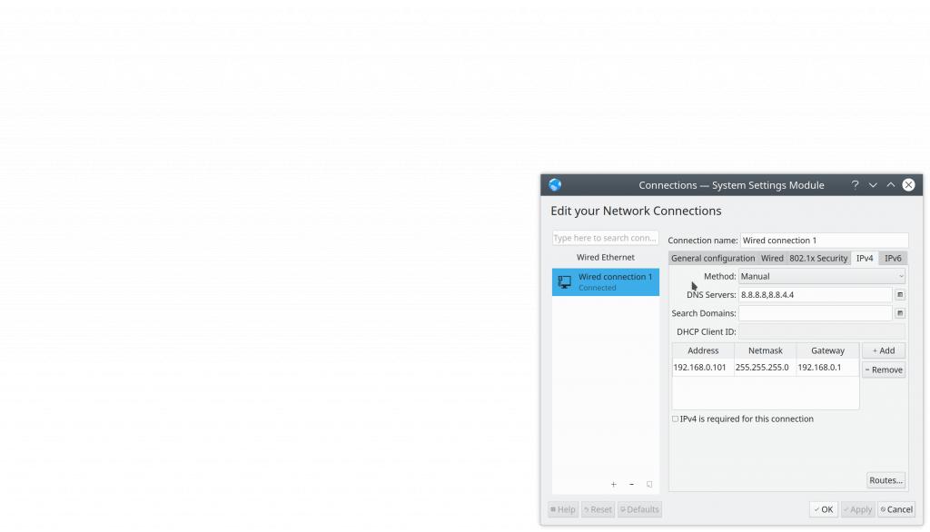

              Go to the ipv4 tab and edit as needed.
