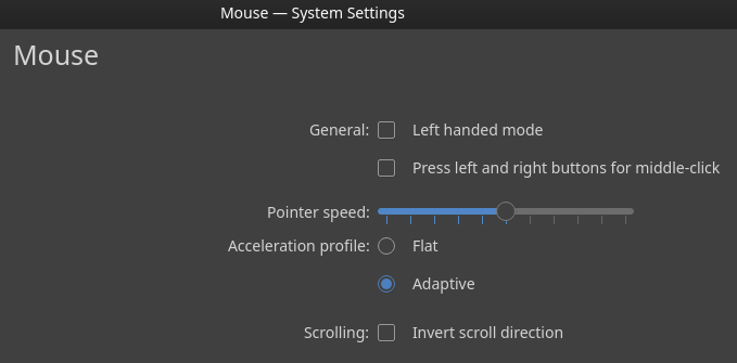

    I don't know... this does look like a "very easy slider control" and it does allow the mouse sensitivity to be controlled properly.
    OK, this is neon 5.18 (Testing) which is basically Kubuntu 18.04 though... is it different there?

      That certainly looks like a 'very easy slider control'.. Wow, am jealous.. Mine looks like this

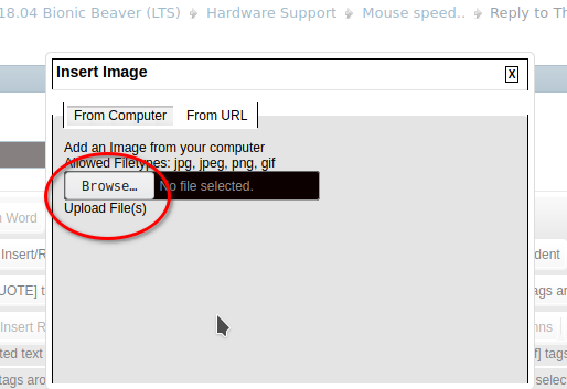

      Oh.. cant seem to post an image.. How did you put yours image onto your post?

        I have Kubuntu 18.04 with a plasma desktop, my mouse settings look nothing like yours but I cant seem to post a screenshot of mine as clicking on the 'add image icon' then demands a url, and dragging the image onto the post results in an icon..

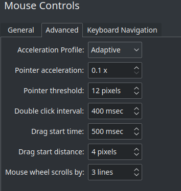

          Uhmmm. Let me check. I have a K18 somewhere on one of these disks...
          You're right. It's totally different, and playing with the values doesn't seem to do anything.

          You probably can't upload an image here because a minimum number of posts is needed (which makes sense, actually).
          You could put it on a free image storage site and link it... but I've just put it here myself, so...

            IIRC, there is spam protection on the forums preventing posting images until you have gathered a sufficient number of posts. I could be wrong, so maybe a mod can confirm?
              The settings differences in the screenshot are likely that the 18.04 is the settings for the "older" evdev mouse driver, the one with the speed slider is the settings for the "newer" libinput.
              (packages: xserver-xorg-input-evdev and xserver-xorg-input-libinput, kubuntu 18.04 seems to be using evdev and neon is using libinput)
                Try this: after clicking on Insert Image, choose From your computer and then click on Browse. In the new file chooser window, navigate to the folder, select the image, click Open, and then Upload.

                  Okay, I get the 'cant post an image yet' thingy.. Thanks for advice chimak111, but that dialogue box does not appear for me, must still be too much of a noob..
                  Thanks again Don, that is exactly the mouse settings I have and yes, they do not appear to change anything except I can make my mouse go even faster which is ridiculous, move my mouse 1 inch and it shoots across 2 x 27" screens in an eyeblink..
