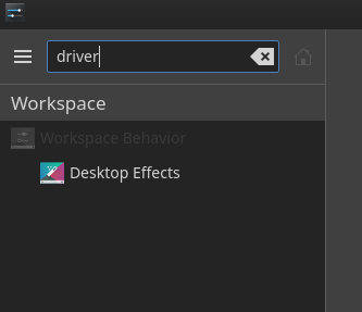

            The driver manager is in System Settings
            Sometimes it isn't.
            If the OP doesn't have it... maybe, sudo apt install software-properties-gtk will help... software-properties-kde does not seem to have a "drivers" tab.

                Sometimes it isn't.
                [ATTACH=CONFIG]8636[/ATTACH]
                It should be, in a stock Kubuntu 18.04. Not at all related to software-properties-kde or gtk
                  Oh, I don't know, he said he didn't have it...
                  Originally posted by kscharf View Post
                  How do I access the Driver Manager? I don't see it under the Kubuntu menu, "which driver-manager" returns nothing in command line.
                  It's "related" in the way that software-properties-kde does not have a "drivers" section but gtk does.
                  I just though it might be of interest. If it isn't, disregard.
                    The system settings module comes in the package "kubuntu-driver-manager", which is installed by default, but might have been removed after installation (it will get removed, for example, if one removes apt-xapian-index which kubuntu-driver-manager depends on)
