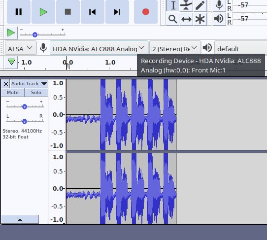

    Finally Audacity can normally record through headphone (front) mic.

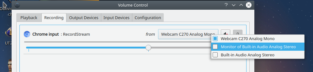

    i found a work around. i need to launch volume control when steam chat is active. then i can see chromium in the applications, and then i can change the input. however, why is this not done automatically? especially when sound card is set as preferred input for recording and especially if i plugged in the mic and muted the camera? normally if i plug something in (external device) i intend to use it so system should have switched to it. i also can't switch easily between inputs. say turn off one and tell system to use the other one as default. there is a default tick box in the volume control applet, but there it doesn't function (i.e. nothing happens when i click it).
