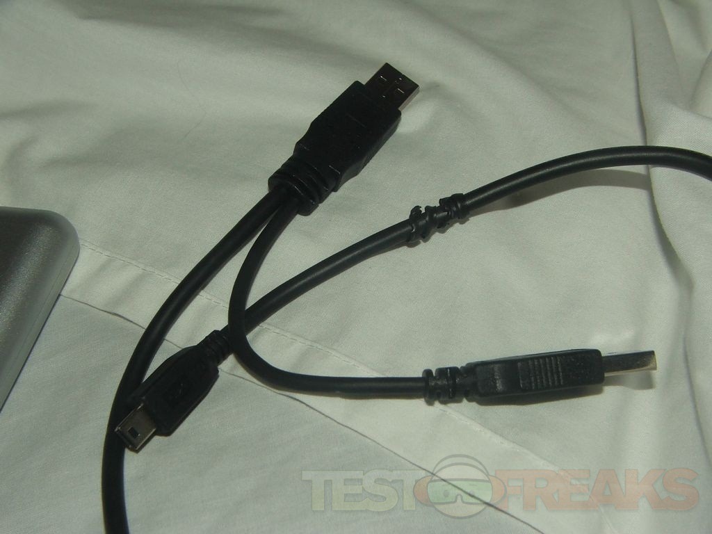

          How many fanouts does the CD Player use? IOW, is your computer supplying enough power through your USB2 (?) port to drive the CD Player. I took out my DVD/CD player and replaced it with an HD Caddy so I could put a 3rd HD into my laptop. I purchased a Samsung External DVD Writer, Model SE-S084D. Its plugin cable is split, with a subminiture D on one end and TWO USB connectors on the other.
          The purpose is to supply two unit loads, or at least 200 ma of power at 5V. One won't do the job.
                https://en.wikipedia.org/wiki/USB#Power
                You know, I remember there being some kind of double cable like that, but the one I am using now is just a single one. I still have the box somewhere, I will check and see if that cable still exists…

                        I'll wager that using a single USB cable instead of the Y splutter supplied by the CD Player is your problem. You can get one from Amazon for $5.

                          And, if your PC is old it may not have a USB 3.0 port so you would need to get a CDROM that works with 2.0, hence the need for a Y cable. IF you do have a USB 3.0 port then more than likely you will only need a cable with USB on one end and the subminiture D connector on the other.
                            And just to be clear for jpc2769, a USB 2 cable will plug in to a USB2 port or to a UB3 port (but it will only run at USB2 speeds, which, IMO, is OK for this DVD). A USB 3 cable will plug in to a USB 3 port or to a USB2 port (but it will run at USB2 speeds in the USB2 port, which, again, for this DVD, would be OK).
                              Thanks for all the suggestions! It was the cable as GreyGeek suggested, I found the double cable in the box and now the drive works!
