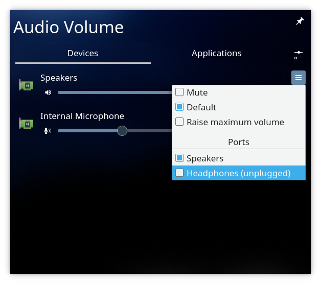

        Try this:
        disable auto mute in alsmixer, as you have done, then use the sound widget like so:
        This is how I do it on my laptop, but I do not have a line-out of course.

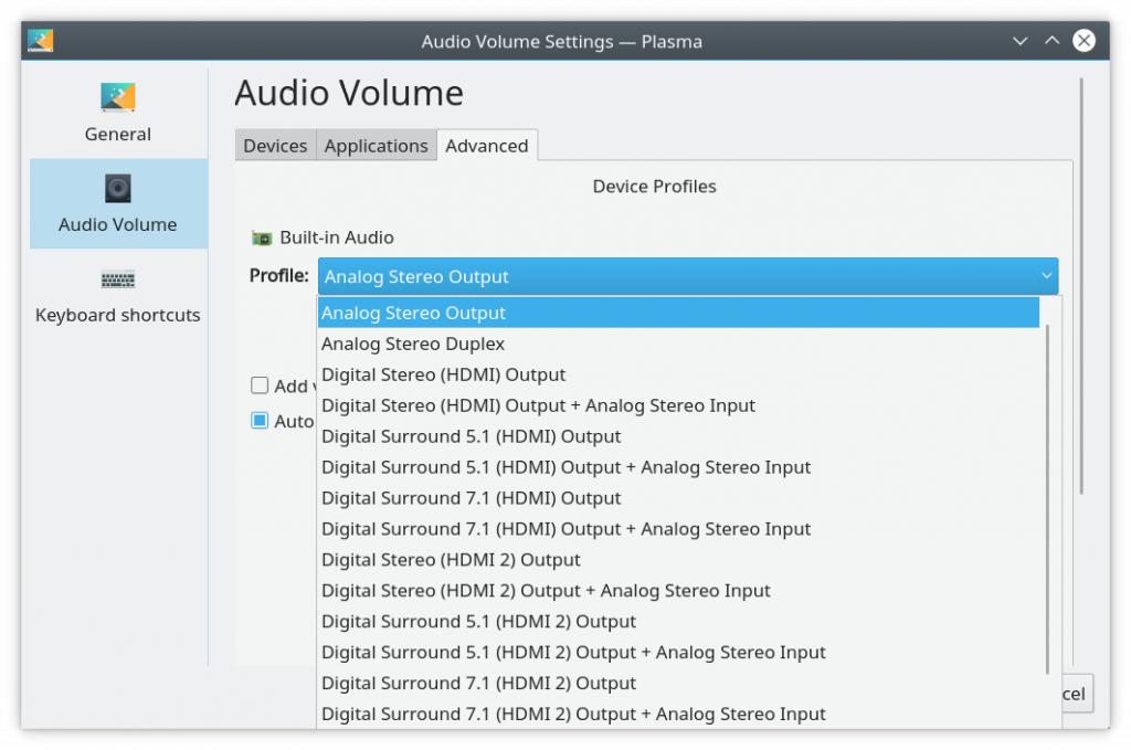

        You might also have to experiment with device profiles as well, but this is unlikely to help, I think.
        Else you may have to try editing Pulseaudio's configs:
        https://wiki.archlinux.org/index.php...are_on-the-fly
        This method should allow you to switch between ports using drag and drop from within the volume control widget

          That is very confusing i am new to linux but i will see what i can do Thanks!
          EDIT: it worked thanks a lot man i really appreciate it do you know why it says unplugged tho it works just fine but it says unplugged
            No clue, to be honest. My laptop says that as well, tho the speakers say "unavailable". My guess is that it cannot tell the difference between .unplugged and switched over. Perhaps it is unplugged, software-wise. Also might just be a minor bug.
            What worked for you, the sound control widget in the systray, or did you have to do all the fancy file editing?
              fancy file editing xD 'cause i tried the the sound control widget before i posted here and it didn't work
