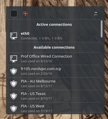

    Now, the network manager widget does not show the wifi icon at all, nor any of the wireless networks.

      Thanks, I did that, but it's still like I have no wifi at all. I have attached a picture of the network manager widget, there used to be a wifi icon next to the airplane, now it is gone; and no wifi connections show up, although I can see (but not connect to) all the old ones if I open network manager settings…

                I have no idea what I am looking at here…
                  Be patient at this point. Don't do anything. There are members here who are very familiar with NetworkManager and Wicd issues. From the output of the listing your provided, the following sticks out prominently to me:
                  [COLOR=#333333]##### network managers ##################[/COLOR]
                  Installed:
                      NetworkManager
                      Wicd
                  You aren't supposed to have more than one network manager installed at the same time, and NetworkManager and Wicd conflict with each other IIRC.
                    OK thanks, I'll do my best ;-)
                      Snowhog is right. NetworkManager and wicd interfere with each other. Use “sudo apt purge wife” to remove it and repost the tests afterwards
                        purge wife? You want to purge your wife? Should that be wicd instead?
                          Seems a bit harsh, have you tried couples' counseling first? ;-)
                          Should it be "sudo apt purge wifi"?
                            Typo! sudo apt purge wicd
                            Having NetworkManager and wicd on the same installation blocks both from working. NetworkManager works fine.
                            Looking at the wifi into output, your wifi, the N-6205, uses the iwlwifi driver. Intel says that support for your device was discontinued on Nov 30, 2017.
                            https://www.intel.com/content/www/us...dual-band.html
                            The latest firmware is at
                            https://www.intel.com/content/www/us...etworking.html
                            which leads to the wiki.kernel.org site
                            https://wireless.wiki.kernel.org/_me...18.168.6.1.tgz
                            which is for the 2.6.35 and higher kernel.
                            I am running 18.04 and checking for the 6000g2 firmware I see
                            file:///lib/firmware/iwlwifi-6000g2a-5.ucode
                            file:///lib/firmware/iwlwifi-6000g2a-6.ucode
                            file:///lib/firmware/iwlwifi-6000g2b-6.ucode
                            I downloaded it and looked at its contents using Ark.
                            As you can see, the date for those files is June 6, 2012 and contains
                            which is the second in the 18.04 listing.
                            If labels mean anything the 3rd listing is the most recent, but I don't know who created it, since it isn't listed on the kernel support site.
                            So, I suspect that if you rename the other two (past "XXX" in front of their names) and reboot you *might* get your wifi back. At least try them one at a time. (IF ANYONE running 16.04 and using this device will show their output of lsmod it would be helpful).
                              OK I will purge wicd and see what happens.
                              I have downloaded that archive, what do I do with it?
