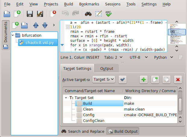

          The first two lines of the setup that I gave should have made the Target Settings Pane appear like so:
            Ah, that's much clearer.
