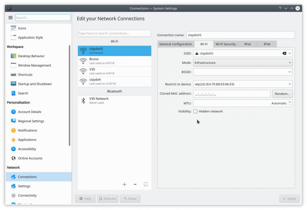

          There is no OK button in System Settings' connections section,

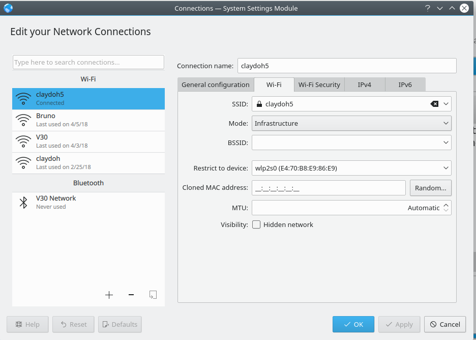

          but there is in the applet popup
