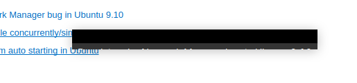

    Hi. I have an issue about tooltips of Chrome. It's not a critical thing but it's rather annoying.
    When I hover the cursor on something which has multi-line tooltip, this tooltip is shown fine. But if, after that, I hover the cursor on something which has a tooltip with only 1 line, this tooltip is shown buggy. The text seems to appear out of tooltip, therefore not readable (only dot of 'i' and tip of 'l' are seen for example). If I move my mouse and hover on the same thing again, it is fixed. But when I repeat the procedure, the bug always happens (first hover on multi-line tooltip, then on 1 line)
    I added a screenshot so you can see what's happening. Is there any way to fix this?

    I have downloaded Ubuntu GNOME to test this on GNOME, the issue also exists there. I think that's a chrome bug? Isn't anyone experiencing the same issue?

      It looks like a shifting hotspot on the pointer icon. Have you tried to increase the size of your mouse pointer icon?
        I have the same issue but it is not limited to Chrome. Mouse pointer size does not affect it.
          Where else do you have it? I only have this on Chrome. And as I said before, it doesn't seem like a KDE-spesific issue.

            Anyway: it looks like a bug in Chrome with some graphic drivers. If you look at the picture answer 120 is linking too, it looks to me the same as what you describe: https://bugs.chromium.org/p/chromium...tail?id=442111
            There are many more reports on tooltips and lots of solutions. Most of the time lots of solutions means there's not one solution really working.
            If it's this bug, I'm afraid you can only wait. But since this bug was reported december 2014, I'm afraid that's gonna be a long wait.

              I don't think it's related to the website because the issue occurs even when hovering on bookmark bar. I'm using intel graphics card and it's a shame if even that driver has these kind of issues.
              Yes, my problem is really similar to that one. I think I better search for a new browser.

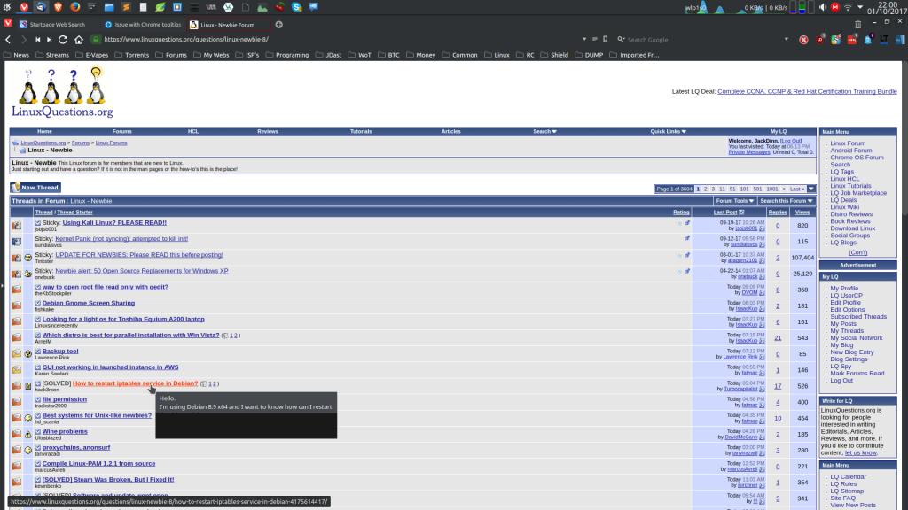

                  For me it occurs in Vivaldi.
                    The bug has indeed nothing to do with that site. I just wanted to be sure there was no mistake in the code. Some people try to manipulate tooltips and really screw them up.
                    Vivaldi is using the same rendering engine as Chrome, so it's no surprice Vivaldi has the same issues. I guess Opera probably has the same bug too.

                      Tried Opera now, has the same bug.
                        and i just dropped firefox for vivaldi. Spent ages skinning vivaldi to my liking and then i notice this tooltip bug
                        So no resolution yet then ?

                          Good news: the bug seems to be fixed. Google Chrome on Linux is on version 61, and in version 62 it's fixed. You can read about it on https://bugs.chromium.org/p/chromium...tail?id=442111
                          Since Vivaldi is using the same rendering engine, it should be fixed in Vivaldi too in not too long.
