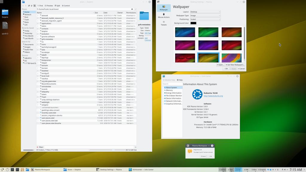

                When I drag the executable bash text file script to the desktop from Dolphin, I get no choice. When I go to delete the created shortcut, I get a popup saying: Widget Removed
                Kubicle:
                I ran the search, and nothing showed. I will try to attach a screenshot. I just plain don't see my syncR-O.sh script/icon/shortcut/widget there anywhere. But yet, there it is to the left as big as life and twice as ugly. :-)
                Plasma is version 5.8.9.
                Frank.
                  This might be the explanation why you aren't having success. I tested my instructions on my 5.12.4 and they work as expected, but unfortunately I don't use desktop icons myself so I have no recollection on how those were handled in 5.8.9 (like whether they were added as widgets rather than .desktop files if you drag-and-drop). But I'm fairly sure there have been changes between the versions.
                  You probably could add a .desktop file manually (I can even provide the steps for you if you wish), but the simplest solution I would recommend is to upgrade your plasma (you'd likely get a few extra benefits as well).
