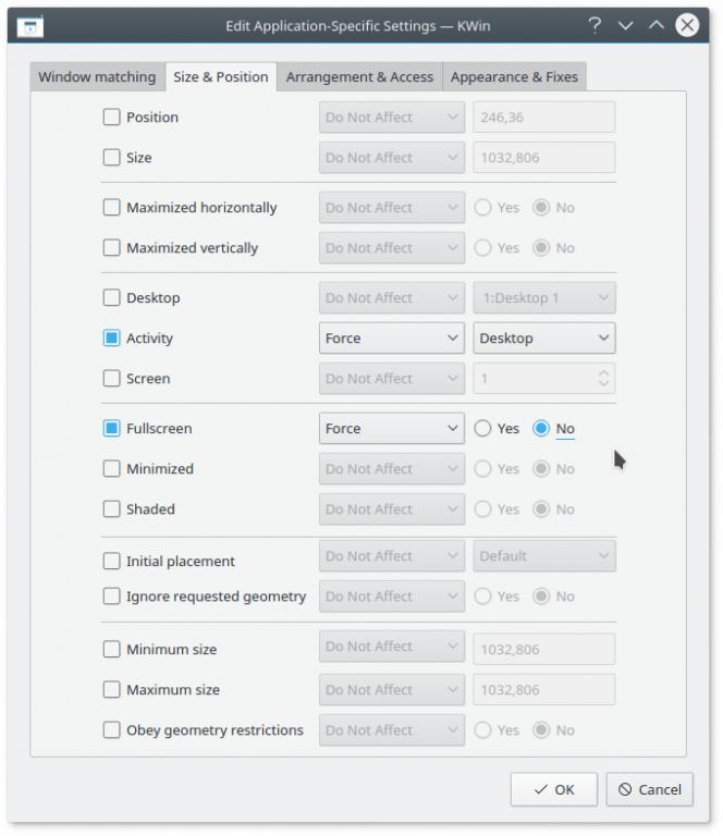

    But, using Neon and also Xenial, I just cannot seem to find the correct combination of tick boxes in two parts of KDE to get a simple thing done: tie an app to an application.
    And I can understand why reviewers say that KDE is "complicated"! lol
    Now, actually that is just part of it, .... I want to basically resize the Plasma Media Center, which I can do, except...... it only works AFTER the initial run of the app and then kind of "randomly"?? :0
    I can tick "do not start full screen" in as many places as are possible and it still opens full screen!
    So.... Is this just a "bug" or what?

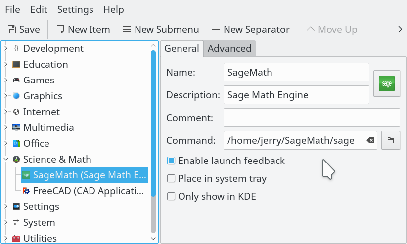

    I don't see ~/Desktop/*.desktop files serving a useful purpose in most cases. Even though they are in the Desktop folder, with the implication that they would appear as icons on the desktop, they do not. I have two that are in my desktop that connect to a Windows exe run under WINE, and the command line in the Menu item points to the IQUAN.desktop file. In that file is the "exec=" line which points to the executable in the .wine/C:\\ directory.
    I added a SageMath desktop file to the Desktop folder and pointed at it with a menu item but it failed to run Sage. I can enter a menu item pointing directly to /home/jerry/SageMath/sage and it works perfectly.
    Here is what SageMath.notebook looks like:
    [Desktop Entry]
    Name=SageMath
    Comment=Sage Math Engine
    Exec=/home/jerry/SageMath/sage /home/jerry/SageMath/notebook.sage
    Icon=/home/jerry/SageMath/sage.png
    Path=$HOME/SageMath
    StartupNotify=true
    Terminal=true
    TerminalOptions=-T "SageMath Notebook"
    Type=Application
    and notebook.sage contains
    notebook(openviewer=True)
    It doesn't work.
    But, this menu entry works fine:

      part of the problem may be that PMC is both still under development with the move to more recent version of Plasma, and is a qml app, as opposed to an executable application so it may not follow all the rules a traditional program does. I can get PMC to open to a specific activity but not (yet) have it force open in windowed mode.
      When you resize PMC from full-screen, right-click on the titlebar, then go to M ore Actions >> Special Application Settings and change the Activity section to "force" and select the desired location.
      There are a huge amount of settings in there, and one set of them may be what you need.
      I may have the combo shortly. I am playing hookey from work so I may be delayed though
        I got it
        I didn't think about forcing the "no" option for full screen
