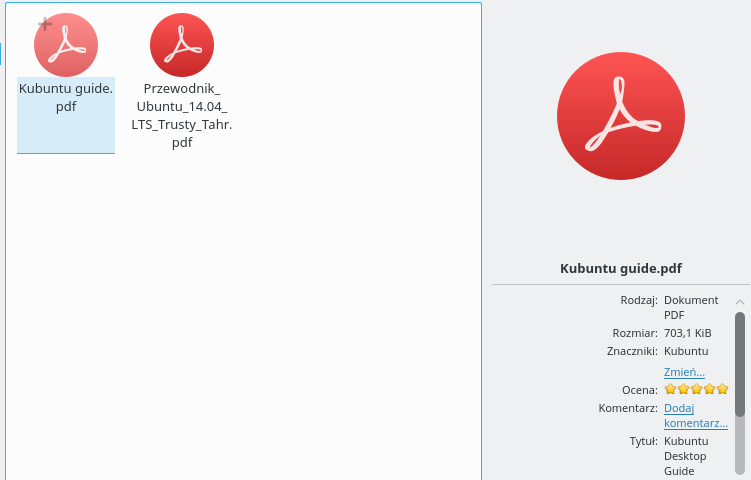

                          By the way, does comments and tags of files under icons in Dolphin works for you? When i add comments, tags etc. to the file they are visible only in right panel as in this image. White space under icon instead of text.
