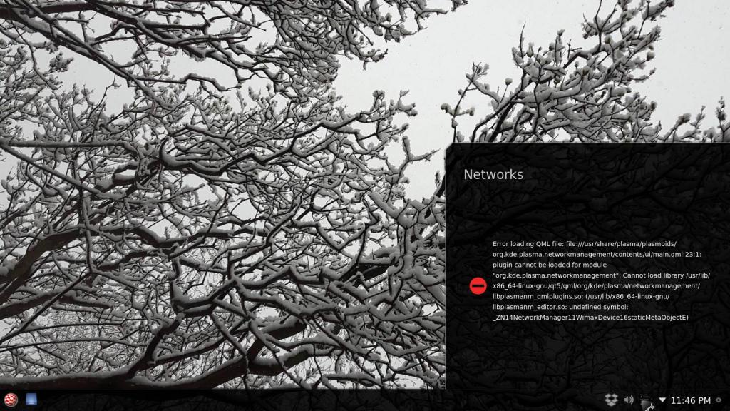

          I booted from a livecd, mounted my filesystem, and used chmod to execute the command. After doing this, I get the same exact error. Screen shot included.
            This issue has an easy fix posted in the bug report (https://bugs.launchpad.net/ubuntu/+s...t/+bug/1569674)
            Comment #39Ovidiu-Florin BOGDAN (ovidiu-florin):
            sudo apt install libkf5networkmanagerqt6=5.18.0-0ubuntu1
            then
            killall plasmashell && plasmashell &
            Fixed my issue!
              Thank You!
