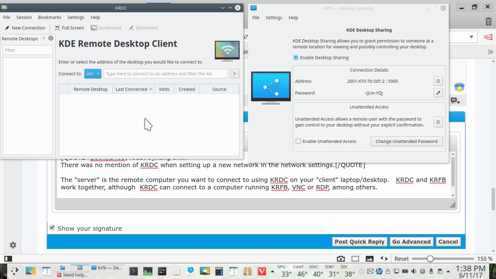

      The "server" is the remote computer you want to connect to using KRDC on your "client" laptop/desktop. KRDC and KRFB work together, although KRDC can connect to a computer running KRFB, VNC or RDP, among others.
      In the image above KRDC is on the left and KRFB is on the right. KRFB is run on the computer you want to connect to. KRDC is run on the computer in front of you. KRFB is a VNC so that is the setting you will want to use. Also, this pair uses port 5900 so you will have to open your firewall (on both machines) to that port for two way traffic. If you have a firewall on your router you'll need to open it up on port 5900 as well.
