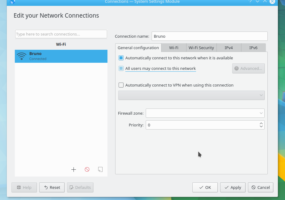

  • kubicle
    replied
    I wasn't aware that "Allow all users to use this connection" meant that it established a network connection before/without the NetworkManager loading the user's network configuration file. Until the login name and password was entered how would the NetworkManager know which config file to use?
    NetworkManager supports two types of network connections, system wide networks (available to all users, network configuration stored in /etc/NetworkManager/system-connections/) and user connections (available to specific user, configuration stored under $HOME).
    Only system wide networks can be connected to before login (IOW automatically during boot), user connections (for obvious reasons) can only be connected to after login.
    The setting "Allow all users to use this connection" defines whether that network is a user only or a system wide network.
    Leave a comment:

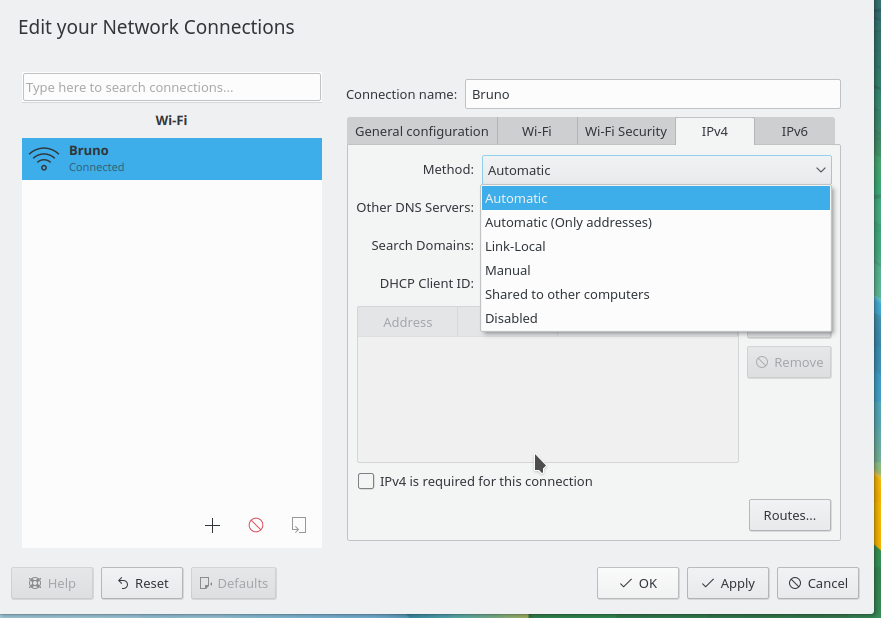

    I believe if you go into your connection's settings, you can check the option to have that connection available to all users, which make it connect before login. That is how I have always done it.
    You also specify static addresses, etc from there.

    If you really want to assign static IPs in /etc/network/interfaces you certainly can, this should help - https://wiki.debian.org/NetworkConfiguration
    Bonus question? It's your plaintext passphrase.
    Enjoy!
