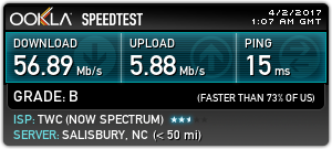

                            well this talk of 5G wireless made me remember that I have that ,,,,,,my ISP (TWC) has me set with 2 wireless connections to my router 1-2.5G and 1-5G ,,,,,I have always used the 2.5G as thats the one the installation Technician had me setup the way I liked .
                            I can go to their web page to my acct. settings and it will display the wireless passwords so I just got the one for the5G and connected to it ,,,,,,,,,,,,,,,,,Dang I should have done this before ,,,I'm getting 56.9 Mbps DL and 5.88 UP

                              very nice yes that's why I would like to get mine working! Works great on my phone but not desktop
