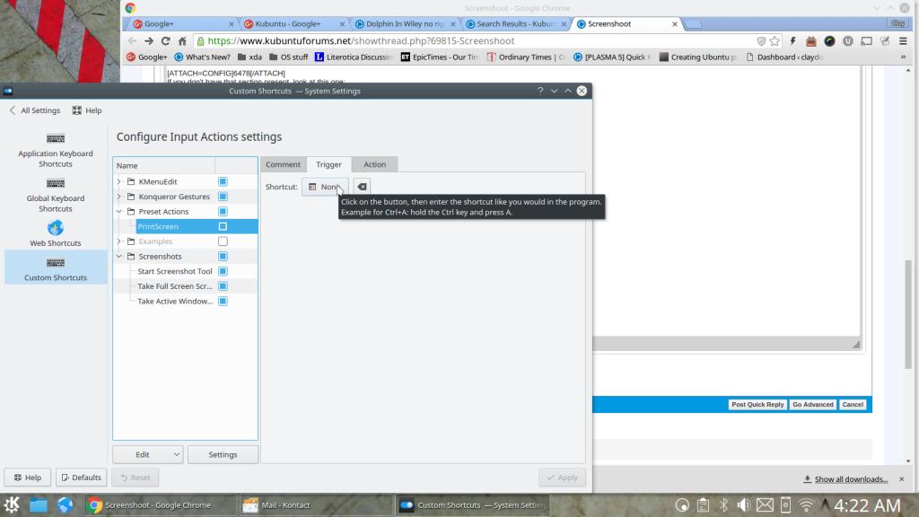

      If you don't have that section present, look at this one:
      Have the Action be /usr/bin/spectacle
        solved,just need to install spectacle
        https://launchpad.net/~kubuntu-ppa/+...+build/9339589
        I don't know why but there was no spectacle in fresh installation
