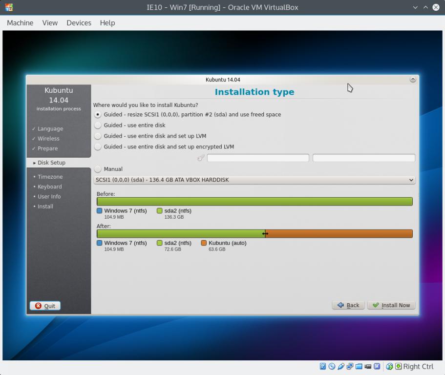

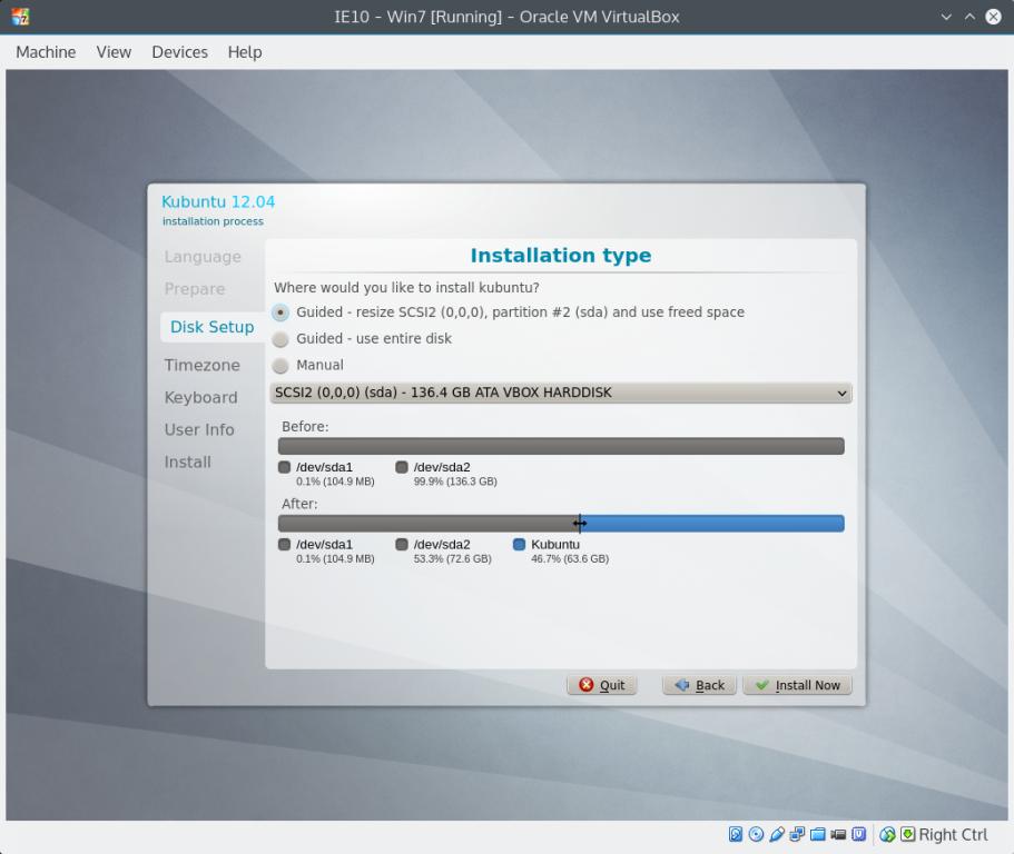

        Aren't these, the "Guided :resize......blah blah" the same as the side-by side?
        Note that this shot is from Virtualbox, so the partitions are not correct, but do note that the bottom selection allows you to drag the divider to allocate more space to one OS, which I had never noticed before 8- (I have not dual-booted in a looong time)
        I don't think the installer is smart enough to be able to detect and resize more than one existing OS install.

          I checked again 14.04--ran it, tried the option to Install Kubuntu. I'm not seeing anything like what you posted. No option to re-size anything, no sliders, no mention of "re-size."
          The options were
          Three options were labeled "Guided" (one is use entire disk; one is use entire disk w/LVM; and one is use entire disk w/encryption).
          The fourth option is Manual
          In fact, the "Before" picture showing my current HDD setup (with 14.04 and 15.04 already installed into existing partitions), was very confusing to read. I never did manage to fully make sense of their "Before" diagram showing my partitions and OSs. The "After" picture was simple, in each case: the entire disk is "blue" with Kubuntu installed! Something is amiss or confusing here, for sure.
            Mention that I am running the 64-bit UEFI version. In fact, in the "After" picture, it showed only Kubuntu taking up the entire drive; it didn't even show the mandatory sda1=ESP partition (500 MB, FAT32) needed for UEFI.
