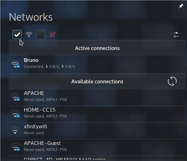

        I don't think that network Manager handles hardware, but only connections (I may be wrong, though).
        It may be redundant, but also make sure that the wifi button is not un-checked:
          it works again
          I know, but it has to recognize the hardware to offer a connection...
          [ATTACH=CONFIG]5998[/ATTACH]
          The button was checked,
          I unchecked it and checked it again and it works again. (WTF! I just don know what triggered it this time, i tried it yesterday 3 or 4 times and nothing happend!)
