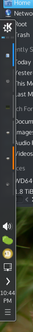

Vertical TaskBar is Borked after upgrade.
    As you can see, my notification icons are quite large while my application icons are extremely small. I've changed themes, installed the Oxygen theme and tried that, switched Nvidia drivers around, and done several other things over the past couple of hours since installing.
    If I move the task bar to the bottom the application icons are more usable, but the notification icons are still a bit bloated. I've had my task bar stuck to the side for ages tho, and really don't want to move it.
    Also, when opening the taskbar in either position from Auto-Hide it frequently glows blue for almost a second before sliding open. I don't know where the blue glow is coming from, but the delay is close to unacceptable.
    This machine was just upgraded from 14.10 tonight. Can't say I'm enjoying this Plasma 5 upgrade, I figured this was just another incremental upgrade, not something that was going to require a complete reconfig and hours of searching solutions.

              My task bar came not good out of the upgrade but I 'just' made a new one and then removed the old.
              Pretty easy really:
              Add panel
              Add standard panel
              Edit the new panel according to your taste
              Two things did not work right away so I went here for help
              Remove old one
