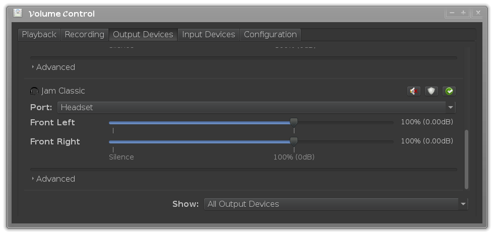

                          however I still like pavucontrol (Pulse Audio volume control) better ,,,,,,,,,it gives you the options of redirecting the streams to different output devices and lets you change all the same hardware settings as in "system settings>multimedia"
                          the output device "Jam classic" is a blue tooth speaker
                          device configuration tab
                          selecting where to send the audio stream from Dolphin
