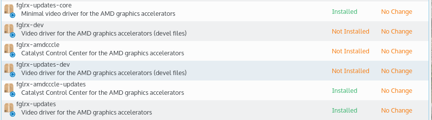

                  Used package manager to install Attachment 1 (in the other forum I belong to there is a box to click to put attachments/images inline with the text - haven't figured out how to do here)

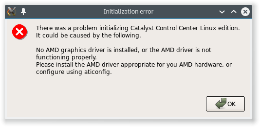

                  Anyway ran : sudo aticonfig --initial
                  The output was:
                  Uninitialised file found, configuring.
                  Using /etc/X11/xorg.conf
                  Saving back-up to /etc/X11/xorg.conf.original-0
                  then ran:
                  aticonfig --lsa
                  * 0. 01:00.0 AMD Radeon HD 7900 Series
                  1. 02:00.0 AMD Radeon HD 7900 Series
                  * - Default adapter
                  terry@Home-Net:~$ aticonfig --lscc
                  X server not active, unable to query CrossFire candidates.
                  terry@Home-Net:~$ fglrxinfo
                  X Error of failed request: BadValue (integer parameter out of range for operation)
                  Major opcode of failed request: 155 (GLX)
                  Minor opcode of failed request: 3 (X_GLXCreateContext)
                  Value in failed request: 0x0
                  Serial number of failed request: 17
                  Current serial number in output stream: 18
                  All of that means nothing to me except that the initialization process mucked things up.
                  Fortunately with the AMD cards the display is still usable. The reason I stopped using the nvideo drivers and refused to buy another computer with them is because doing that with the nvideo driverfs always really messed up the display.
                  Does the above mean something to someone and how do I go about fixing it?
                    Rebooted - sometimes that fixes some problems.
                    Rebooted and ran fglrxinfo - output indicated that the driver was running okay now.
                    Then ran Catalyst Control Center and it popped up nice and pretty.
                    Seems the reboot fixed whatever was wrong again.
