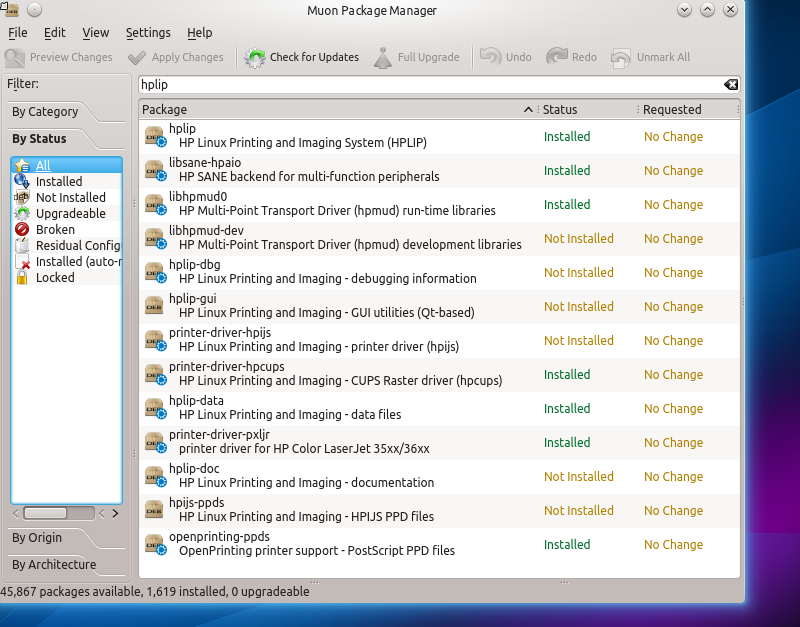

        One thing more: when I look in Muon Package Manager, it says that much of the software that I KNOW is installed from the hplipopensource site because all the features are available is NOT there, i.e., not installed.

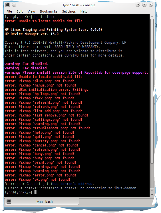

            I've attached a screenshot showing the results of my running hp-toolbox.Click image for larger version

              Please copy and paste the text from terminal output in the future, instead of a screenshot. It makes it so much easier for readers to then copy and paste things for search purposes.

              From a quick search, it may be that for some reason the package libsane-hpaio did not get pulled in when installing the package hplip-gui, or it became corrupted.
              (libsane-hpaio provides the libraries that Linux's SANE scanning backend needs for scanning support)
              Please try [re]installing that, and see if that allows the toolbox to run. As I mentioned before, it may be a good idea to reinstall the package hplip-gui in order to reinstall the menu icons that seem to have gone missing, maybe even uninstalling it with the Purge option in Muon, then reinstalling.
              hplip-gui is the package in Ubuntu/Debian type distros that contains various graphical parts of the hplip software, including hp-toolbox
              In a default (K)ubuntu install, the only HP specific things installed are mostly the drivers, and some libraries and backend tools
                        Those missing files belong to the package hplip-data. My reading of apt show hplip-data
                         $ apt show hplip-data
                        Package: hplip-data
                        Task: ubuntu-desktop, ubuntu-usb, kubuntu-desktop, kubuntu-active, kubuntu-active-desktop, kubuntu-active, edubuntu-desktop, edubuntu-usb, xubuntu-desktop, xubuntu-core, lubuntu-core, ubuntustudio-desktop-minimal, ubuntustudio-desktop, ubuntu-gnome-desktop, ubuntukylin-desktop
                        APT-Manual-Installed: yes
                        suggests that it comes with kubuntu-desktop, and is not marked as a dependency of hplip-gui, which provides hp-toolbox.
                         $ apt show hplip-gui
                        Package: hplip-gui
                        Depends: hplip (>= 3.14.6-1ubuntu1), dbus-x11, python-qt4, python-qt4-dbus, gksu | kdebase-bin (<< 4:4.4.0-1) | kde-runtime | kdebase-runtime | kdesudo | ktsuss
                        Perhaps when you uninstalled lots of hplip stuff, you took out stuff which comes with Kubuntu. IMO this should have been ok, because IMO hplip-gui should have hplip-data as a dependency.
