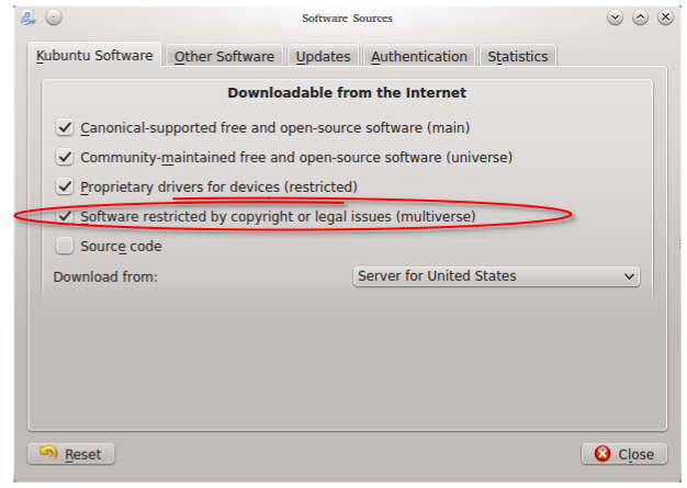

        You have to have the multiverse repository enabled.
