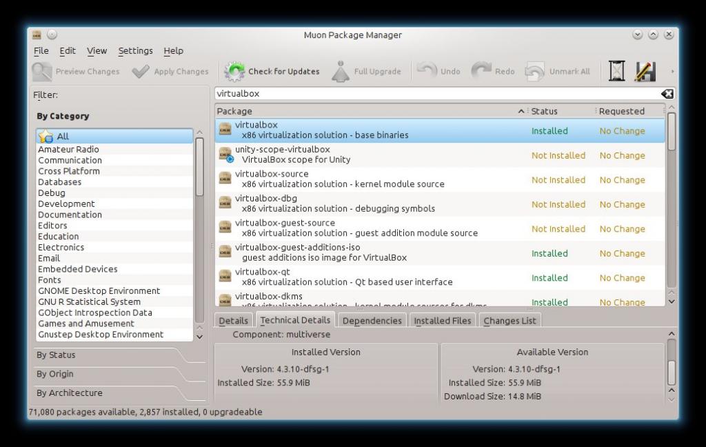

      Yup. Here is what is in my repository, which was set up when I installed Trusty.
      which is the 4.3.10-dfsg-1 version.

      As you can see, I am running Trusty and installing Utopic as a guest OS. I think I will uninstall 4.3.10 and replace it with 4.3.18 from Oracle's website. What do you think?
        Using the Oracle repo in my Trusty host let Guest Additions install and work in a Utopic guest.
        The Ubuntu repo seems to have caught up in Utopic, but history says it will start lagging again and newer kernels will break. The VB folks have often complained that Ubuntu does odd things with kernels.
          Excellent! That was the node to practical experience that I wanted to hear. Now it's off to get the 4.3.18 version
