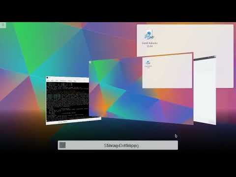

        If you still cannot get it to install but would like to look at plasma5 in action then watch this
          http://cdimage.ubuntu.com/kubuntu/daily-live/current/
