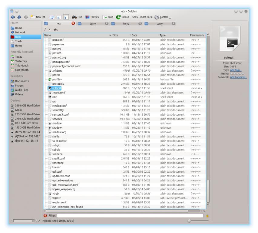

    Recently got to looking through the /etc directory and noticed something strange: No /etc/rcX.d directories: see attachment
    Could the lack of any rcX.d directories and files prevent power shutdown?? Seems like it could to me.
    How do I restore the needed directories??

      sudo apt-get install sysv-rc-conf
      It created all of the rcX.d directories, but the machine still does not power off.
