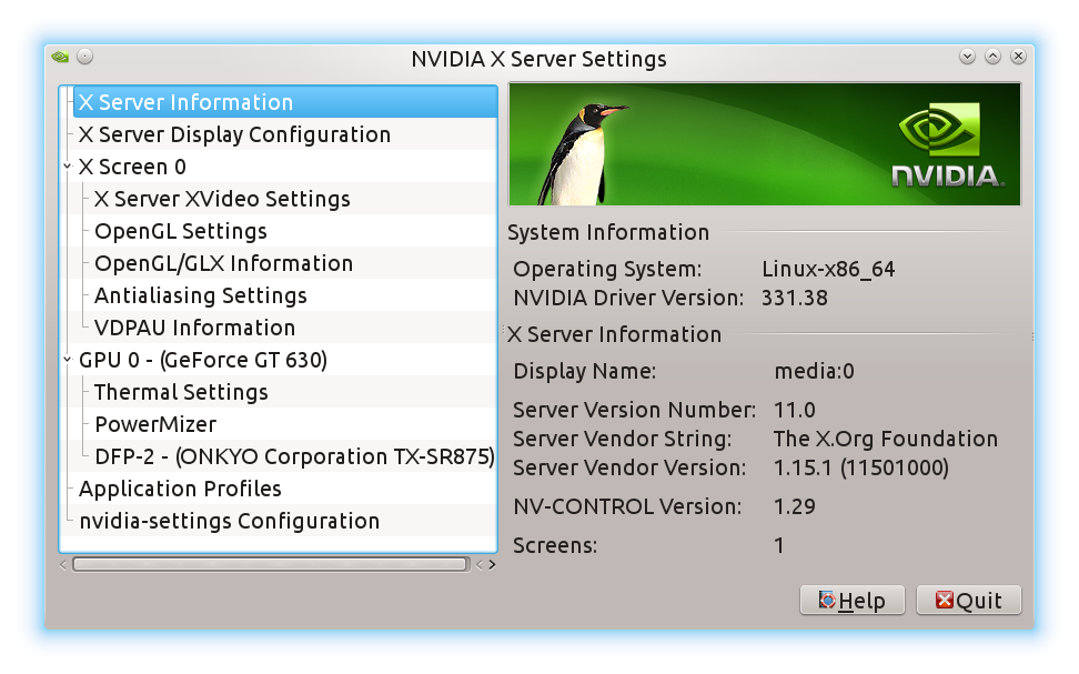

                      So, it looks like it was successful. Now to reboot and see if it does work. I'll post a follow up message once the reboot completes.
                      Frank.
                        #26
                        Steve:
                        Works! All effects are back.
                        The nVidia driver even correctly picked up the model number of my home theatre, which is between the computer and the HDMI flat panel TV!
                        Happiness!
                        Thank you for walking me through this. I have learned a lot, and have taken a lot of notes on this.
                        Now to do yet another security update.... Hope nothing breaks THIS time.
                        Frank.
