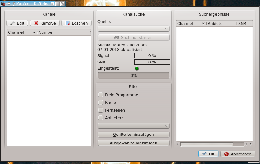

    Up to now when I wanted to watch Satellite TV I had no problems. But since this new installation, I get nothing. I can not even make a search as there is no list of the satellites at all. I am aware, to do a search of all channels, the interface from Kaffeine has to be closed.
    I made a picture to illustrate this: open Kaffeine and, on the menu choose TV/Fernsehen, then on Channels/Kanäle. Now, concentrate on the middle column. On top you are told that you are at the Channel Search/Kanalsuche. Quelle means search. But in that field just under «Source» is usually a list with all the Satellites and their channels. But this list is missing. Consequently I can not start the search with the following bit. Of course, the firmware is correctly installed. The decoder card is from TechnoTrend.
    Please open the link, there is a screen shot from my situation.

                I am studying Ubuntuusers.de, which brought me to the idea that perhaps my TechnoTrend card is not recognised at all, and the fault is not with Kaffeine but with the hardware.
                How can I check, if the card is working?

                          Daft as I am, I did not read my notes about Installing Kaffeine. My shame! I completely forgot to select the Satellites. From then on it was a kid's game to install the channels from the 2 Satellites.
                          However, I now don't get either picture nor sound. Here is the latest Diagnostic log:
                          19:26:08 VlcMediaWidget::setVolume: cannot set volume 100
                          19:26:08 DvbManager::loadDeviceManager: using built-in dvb device manager
                          19:26:10 DvbLinuxDevice::startDevice: found dvb device "P1131714613c2000e" 47 "ST STV0299 DVB-S"
                          19:26:12 DvbLinuxDevice::tune: DvbS "S 993750 H 22000000 5/6"
                          19:26:13 DvbDevice::frontendEvent: tuning failed
                          Any suggestions?
