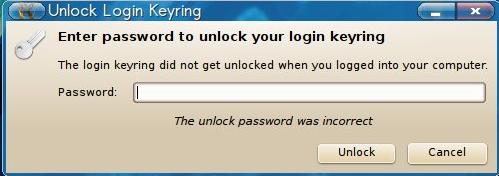

            I've just restarted several times in Kubuntu 14.04 and every time this *&^*^#@ popup dialog comes up "Enter password to unlock your login keyring".
Name:	Kubuntu 14-04 (Trusty) new Skype login problem - Keyring dialog.jpeg
            Skype is causing this as it won't login until you relent and type your user password into the keyring box. I also see that there is a process running called "gnome-keyring-daemon" which I'm sure wasn't running before.
            Damn Skype, we don't want Gnome stuff running unnecessarily here in our pristine KDE Plasma!

                I had this problem some time ago and I was advised to install gnome-keyring. I hope that this works for you as well.

                    The MS developer "JonasT" recommended that only libsecret needed to be installed to solve the login problem. I already had libsecret installed, so in desperation I installed the Gnome stuff.

                      I seem to be getting different behaviour between my desktop (Kubuntu 14.04 - auto login enabled) and my laptop (Mint KDE 18.2 - auto login disabled).
                      My desktop is causing the keyring issue with Skype (8.11.04) but the laptop Skype (same version) is neither prompting for the keyring password and Skype is logging in as it should automatically.
                      I think the simplest solution might be to change my desktop to auto login disabled (so I will need to supply my password on desktop login) and then Skype should start and login without complaint. I will report back if that solution doesn't work.

                              All the friends that I have are on MS Windows and use Skype. Therefore, I will stay with Skype. I found that the latest version will only work correctly with gnome-keyring installed. I hope MS fixes that limitation in the next release as all those using KDE are not keen on installing a gnome equivalent to kwallet.
