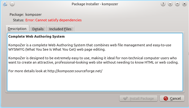

      Please understand, I don't believe this has anything to do with Bluefish. It happens with every install I attempt from: terminal, Synaptic, and deb installer.
Name:	deb install error.png
