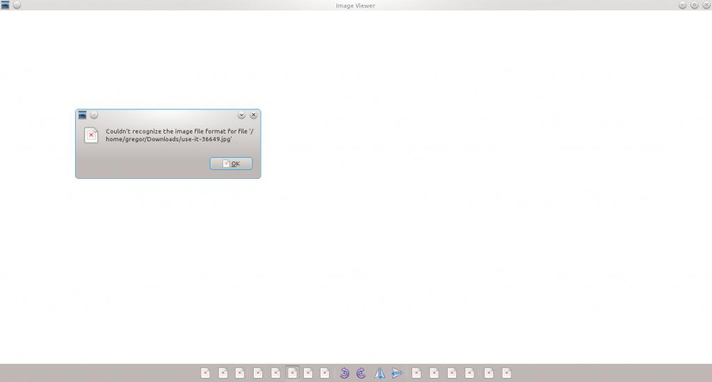

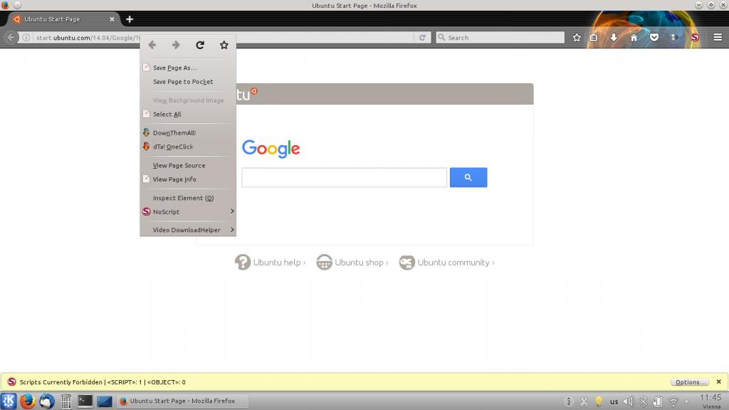

                        I just hit into this issue. i don't want to update to 16.04 yet, as i have an AMD GPU for which the support is still slightly better under 14.04 with fglrx drivers.
                        The menu boxes for OK and cancel have X and empty icon inside. the file upload menu and similar menues does not appear to work at all. non resnponsive.
                        The strange issue is not limited to firefox (ver. 53.0 64-bit), but to some other gtk software as well such as image viewer gpicview. i was using that viewer as it is very fast to load.
                        now it is throwing out errors if i run it from terminal e.g.:
                        gpicview
                        (gpicview:7792): Gtk-WARNING **: Error loading icon: Couldn't recognize the image file format for file '/usr/share/icons/oxygen/22x22/actions/go-previous.png'
                        (gpicview:7792): Gtk-WARNING **: Error loading icon: Couldn't recognize the image file format for file '/usr/share/icons/oxygen/16x16/actions/go-previous.png'
                        (gpicview:7792): Gtk-WARNING **: Error loading icon: Couldn't recognize the image file format for file '/usr/share/icons/oxygen/32x32/actions/go-previous.png'
                        (gpicview:7792): Gtk-WARNING **: Error loading icon: Couldn't recognize the image file format for file '/usr/share/icons/oxygen/22x22/actions/go-next.png'
                        (gpicview:7792): Gtk-WARNING **: Error loading icon: Couldn't recognize the image file format for file '/usr/share/icons/oxygen/16x16/actions/go-next.png'
                        (gpicview:7792): Gtk-WARNING **: Error loading icon: Couldn't recognize the image file format for file '/usr/share/icons/oxygen/32x32/actions/go-next.png'
                        (gpicview:7792): Gtk-WARNING **: Error loading icon: Couldn't recognize the image file format for file '/usr/share/icons/oxygen/22x22/actions/media-playback-start.png'
                        (gpicview:7792): Gtk-WARNING **: Error loading icon: Couldn't recognize the image file format for file '/usr/share/icons/oxygen/16x16/actions/media-playback-start.png'
                        (gpicview:7792): Gtk-WARNING **: Error loading icon: Couldn't recognize the image file format for file '/usr/share/icons/oxygen/32x32/actions/media-playback-start.png'
                        The bizzare thing is that another PC with Kubuntu 14.04 works just fine.
                        Any solutions? and if not can you suggest alternatives? should i use Chrome/Chromium instead? but firefox was the "official browser".
                        What about the image viewer. Gvenview is too heavy and too complex. is there anything simple & qt based that would work?
                        Or should i do a reinstall of the whole OS?
ID:	643502Click image for larger version

                          When 'missing icons' are experienced, it is almost entirely due to either the Desktop Theme or Icon Theme that one is using. Have you tried setting both back to the defaults?
                            #28
                            I solved the Firefox file dialog problem in K14.04 here by changing the GTK3 theme in System Settings, Application Appearance, GTK to the Emacs theme. It looks ugly and doesn't fit with the rest of the OS but it is at least functional. I changed the font to DejaVu Sans 8 too. The default GTK3 theme in K14.04 just doesn't work at all in Firefox as you've seen. You need to restart Firefox to see the changes.
                            You could maybe download a more attractive GTK3 theme but not via the "Get New Themes" button as it doesn't work any more it seems.

                              #29
                              now that you mentioned it, i vaguely remember having some issues with theme. default one is too bright for this laptop. in any case i switched to oxygen dark, used raleigh for GTK2 to get the icons back. now the only issue is image viewer gpicview. while it has the icons for osme reason it can not open any of the photos. i will troubleshoot it elsewhere.
                              but i will still leave a quesiton here - what other viewer would you recomend that is light, opens fast and works well in KDE? it would need to have picture viewing abilities and ability to temporary rotate the photo, zoom in and out and that's about it.

                                I had mouse issues with command "MOZ_USE_XINPUT2=1 firefox".
                                So, i uninstalled gtk3-engines-oxygen, then relog [or restart] , that should fix gtk3 themes.
                                If not install gnome-tweak-tool
