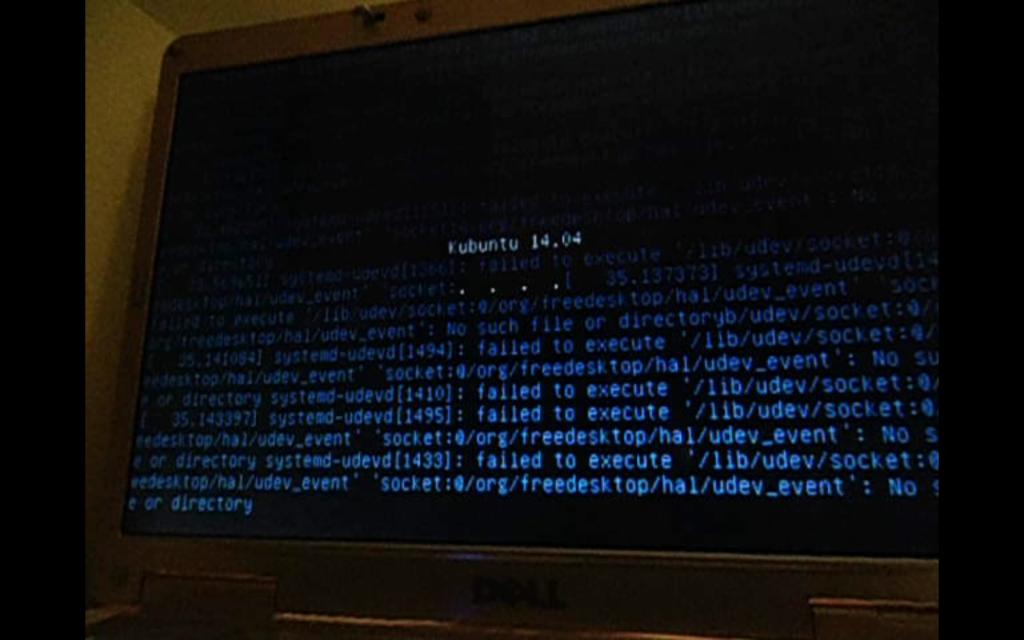

When my computer is booting there are lines that say unable to execute and it runs these line several times until the screen goes to the kubuntu boot screen, the blue one. This started after the 12.04 to 14.04 upgrade. Machine runs fine but does anyone know how to fix this. Picture attached. Have a small video but don't know how to upload it. Thank you.
Strange boot up
Hal ?
Tweaking the perspective...
Error seems to be:
Searching with the error message...systemd-udevd [ ]: failed to execute '/lib/udev/socket:@/org/freedesktop/hal/udev_event' 'socket:@/org/freedesktop/hal/udev_event': No such file or directory'

I looked at the bugs from oneline and this seems to be my problem. Now does anyone know if it's safe to remove HAL?Alienware 17 R2

simulate a purg with apt-get and see what will happen (be removed) "hal" dose not exist on my 14.04 install , but you may have installed something that needed it IDK .
and see what it says .Code:sudo apt-get -s purge hal

The following packages will be REMOVED:
hal* thoggen*
0 upgraded, 0 newly installed, 2 to remove and 0 not upgraded.
Purg thoggen [0.7.1-1ubuntu1]
Purg hal [0.5.14-8]
what on earth is thoggen??Alienware 17 R2

I went ahead and purged hal and now it boots correctly and faster. Since this was an upgrade instead of a fresh install I suppose hal was a left over. Thank you all.Alienware 17 R2

yes that would be correct (the "left over" part) ......... leftovers can get stale after a wile ,,,,,,,, LOLOriginally posted by eddieg538 View PostI went ahead and purged hal and now it boots correctly and faster. Since this was an upgrade instead of a fresh install I suppose hal was a left over. Thank you all.

HAL was deprecated many years ago. The kernel, X, and Udev are much better at detecting and managing hardware.
