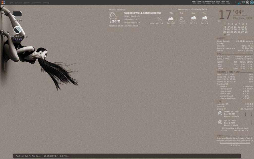

      screenshot (not mine)

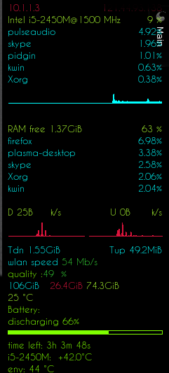

            my laptop one looks like this:
