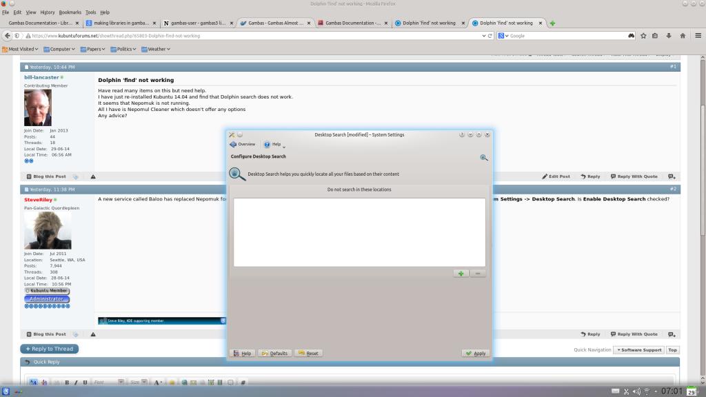

    A new service called Baloo has replaced Nepomuk for indexing and searching files and emails. Check that the Baloo service is running on your machine. Open System Settings -> Desktop Search. Is Enable Desktop Search checked?
      Thanks Steve, my desktop search does not have an enabled option, see snapshot.Click image for larger version
        Look at System Settings > Desktop Search Advanced

          I ran updates and now I have an 'Enable Desktop Search" check box which was set to 'yes' as default. Search is still
          not working.
          I do not have Desktop Search Advanced.

            Verify that you have baloo-kcmadv installed.
