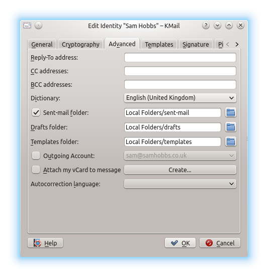

            Hmmmm do you mean your mail Local Folders, the default mailboxes that actually sit on your computer, or your account-specific folders? I have been using my Local inbox and other folders there specifically for things I want saved for local use.
            Yep I meant that when I sent an email from that account the draft would be stored in the local draft folder, and the sent message would be stored in the local sent messages folder. After some investigation, I found out why:
            So... I can manually change those settings so that it stashes stuff in the IMAP folders. Did yours do this by default when you configured it or did you have to do it manually? I may have missed an option during setup (you mention disconnected mode... was that a checkbox?).
              [ATTACH=CONFIG]4913[/ATTACH]
              I don't think it does it by default - trouble is, that the IMAP standard does not define sent/draft/template folders, so every server and email client has different defaults, my accounts always end up with "Sent", "Sent Mail" etc folders.
              I'm pretty sure Thunderbird defaults to a local sent folder as well.
