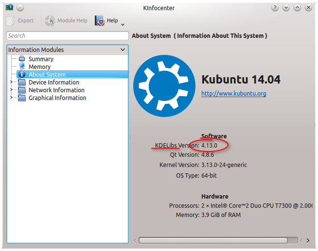

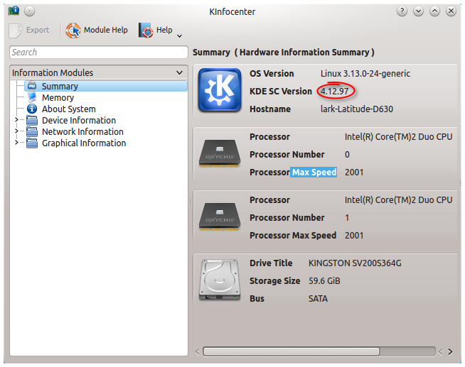

        where are you seeing 4.12.97? Kinfocenter does show it (not sure what package it gets that info from) but if you look at the actual packages, you should see 4.13 - after updating.
        4.12.97 was the rc of 4.13, due to release timing between Ubuntu and KDE, this was the version on release day. 4.13 final came very shortly afterward
        To make even more confusing, as not all the applications of KDE SC saw updated versions, you will see some 4.11 things in there as well. All is OK though. Confusing, but OK

                where are you seeing 4.12.97? Kinfocenter does show it (not sure what package it gets that info from)...
                The 'KDE SC Version' version in the KInfocenter is telling the build moment KDE library version. It is not telling what you are now using.
