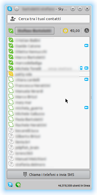

    I've just installed Kubuntu 14.04 64bit, and Skype isn't using the standard theme that I have chosen for Gtk+ applications (oxygen-gtk).
    Other programs work like intended, in example Firefox and Gimp correctly use the oxygen-gtk theme, but Skype refuses to do so. And, also the cursor theme is different when the cursor passes over a Skype window; I use the standard Oxygen White theme, but when I'm over a Skype window, it falls back to plain (and ugly) black cursors. You can see all of this in the following screenshot.
    Inside Skype, under Options>General>Style, I've selected Desktop I've selected "Desktop Settigns".
    How can I solve this? Please note that under Kubuntu 12.04 at 32 bit it worked correctly; is this behaviour caused by the switch to a 64bit system?

                Quickly looking at a google search, it looks like you may be missing the package libxcursor1:i386
                sudo apt-get install libxcursor1
                This is a 32-bit library, and as skype is a 32-bit only application, it needs this (:i386) to fix the black cursor problem. It was installed on my systems, but I am guessing that the packaging for it might not pull it in automagically.
                I don't quite understand what you mean by the icon theme changing, but I am guessing that some icons change in Skype itself when you pass the mouse over a skype window? Which icons? I can't reproduce this one.
                  I'm sorry, it was a mistake from my part, I was meaning the the cursor theme is changing not the icon theme; I have accordingly corrected my original post.
                  That package was already present on my system, but it was the amd64 version; I've also installed the i386 version, and now I have them both: I suppose that this is not a problem, isn't it?
                  With it, the cursors over any Skype window now follow my global settings.
