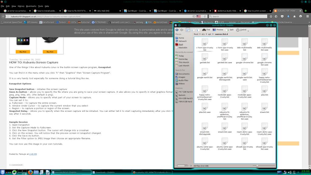

                        These are 'root owned' files, so you will have to delete them 'as root'. Either open a console and delete them there:
                        cd /etc/apt/sources.list.d
                        sudo rm google-chrome.list*
                        sudo rm c-korn-ppa-trusty*
                        or launch Dolphin 'as root' by clicking on the Desktop and then typing:
                        kdesudo dolphin
                        Press enter. Type your user password when prompted. Press enter.
                        Navigate to /etc/apt/sources.list.d and delete the files I've specified. Close dolphin when done.

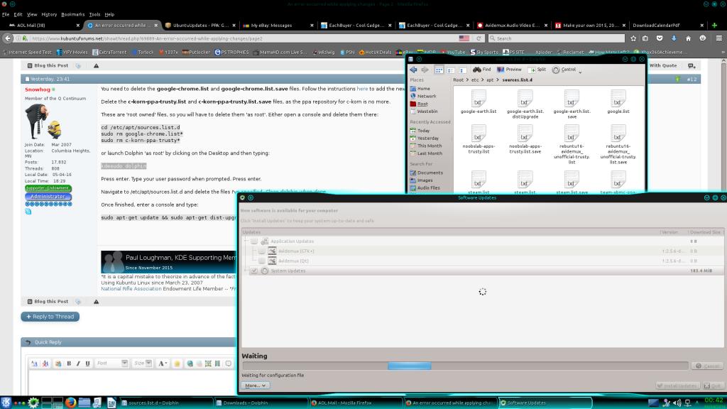

                          I done everything you said mate and it was all installing well until it just sits at this point on the update.
Name:	waiting config file.jpg
                            Don't use the graphical package manager; run the commands from a konsole.
                            You'll need to quite the graphical app and wait a few seconds, then open a konsole and run the commands.

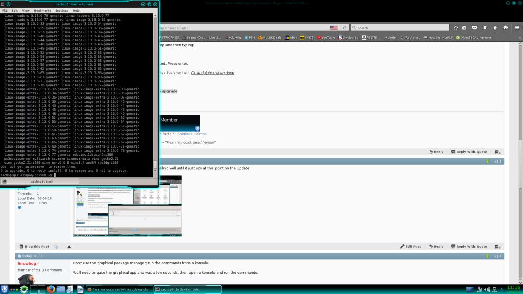

                              This is what I get now mate.
