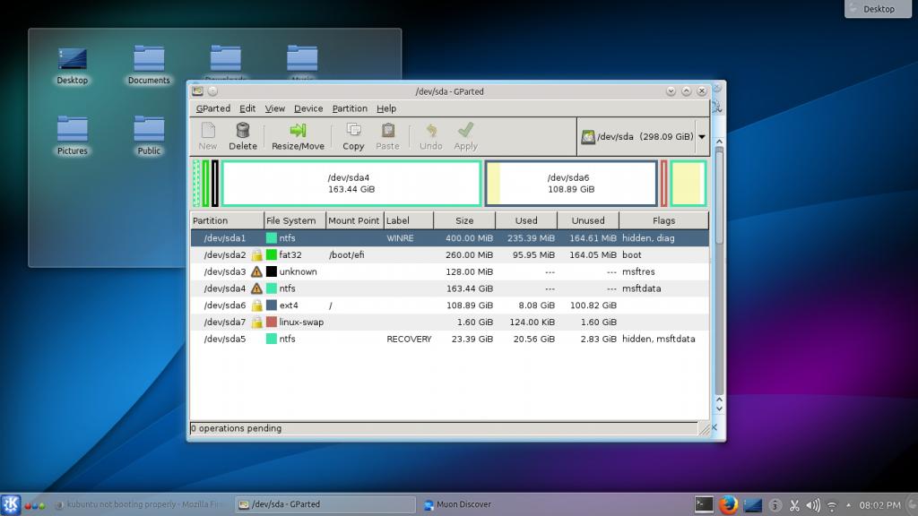

      didn't seem to help, when i did update grub it looked like it found everything, just won't give me grub without going through the hoops
      something looks funny here though
      should I reinstall with secure boot turned back on
