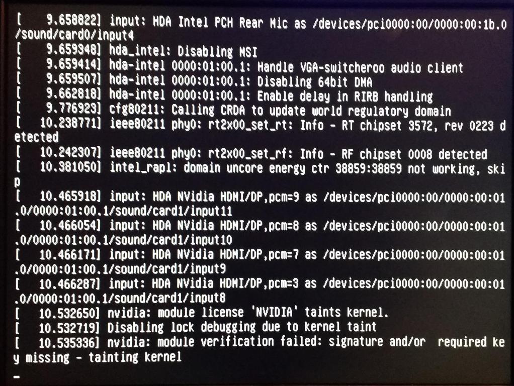

    OK, got an adapter for the DVI port on the nVidia card so that I can use the analog VGA cable on the monitor. Managed to enter the Ubuntu safe mode screen (ESC when at the manufacturer splash screen), and booted in safe mode. Saw all the console output go flying by. Picture attached of where it stopped.
    Seems this is a kernel bug, according to this information.
    However, not sure what to do now.
    Still looking for suggestions.
    Author of the bug report says he manually installed an older kernel. Suggestions on how to do that?

      the author allso sead the newer kernel @hear http://kernel.ubuntu.com/~kernel-ppa...15-rc2-trusty/ worked for him .
