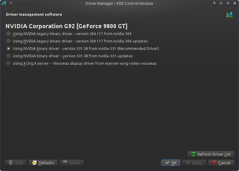

        I'm back on the NVidia driver now.
        Well, I used to use jockey but I now use the Driver Manager utility from the KDE menu.
        I just selected the recommended driver and clicked apply.
Name:	service manager dialog40.png

                    So... whatcha thinking?

                      Please log out of the desktop. When you see the login screen, press Ctrl+Alt+F2. You will see a console login prompt. Please log in with your normal user ID and password. Run the following two commands:
                      rm -rfv /var/tmp/kdecache-$USER
                      sudo rm -rfv /var/tmp/kdecache-root
                      Next, reboot:
                      sudo reboot
                      Can you now manipulate services normally?
                      Thanks Steve! I had the same problem as the original post, except it is on a laptop. It happened after I unchecked both "Drive Ejector" (because I have no CDROM) and "Touchpad" (because I thought it was redundant with "KDE Touchpas Enabler Demon"). Then I eventually restarted the laptop. After which problems such as the issue with KDED started to appear. Among other things, I was also experiencing delays from Dolphin: it would take one or two minutes before reacting to a mouse click, but only the first time in a new window, then it would behave as expected.
                      Finally, after the operation you suggested and rebooting the machine, I could access KDE Services Configuration without the KDED error, then I restored the disabled services, rebooted once more. Since I did that it works just as it used to.

                          Upon trying to access Power Management through System Settings I receive an awesome red box with an X in it and the following: "Power Management configuration module could not be loaded. The Power Management Service appears not to be running. This can be solved by starting or scheduling it inside "Startup and Shutdown"
                          When I go to Startup and Shutdown and then Service Manager I get another awesome red box with the X through it and "Unable to contact KDED." Both Load-on-Demand Services and Startup Services are greyed out and all entries display a Status of "Not running".
                          I'm sure some additional information would be most helpful - but I can't even guess what that would be.
                          Thanks in advance for some help on a most frustrating problem!
                          For what it's worth.... For various reasons I ended up switching to Netrunner a few months ago and experienced the exact same problem as I documented above. Upgrades released this week magically solved my entire issue. So that's good
                            #28
                            Confirmed - enabled kscreen.desktop again and service manager now works correctly without any mods. That IS good.
