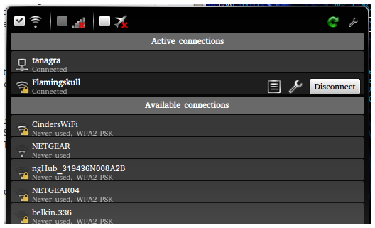

    You see this:
      Yes - that's what I'm calling the networking icon popup menu. My wireless checkbox is unchecked and unchangeable. I have one active connection - my wired connection. No available connections are show, doubtless because I have no wireless connectivity.

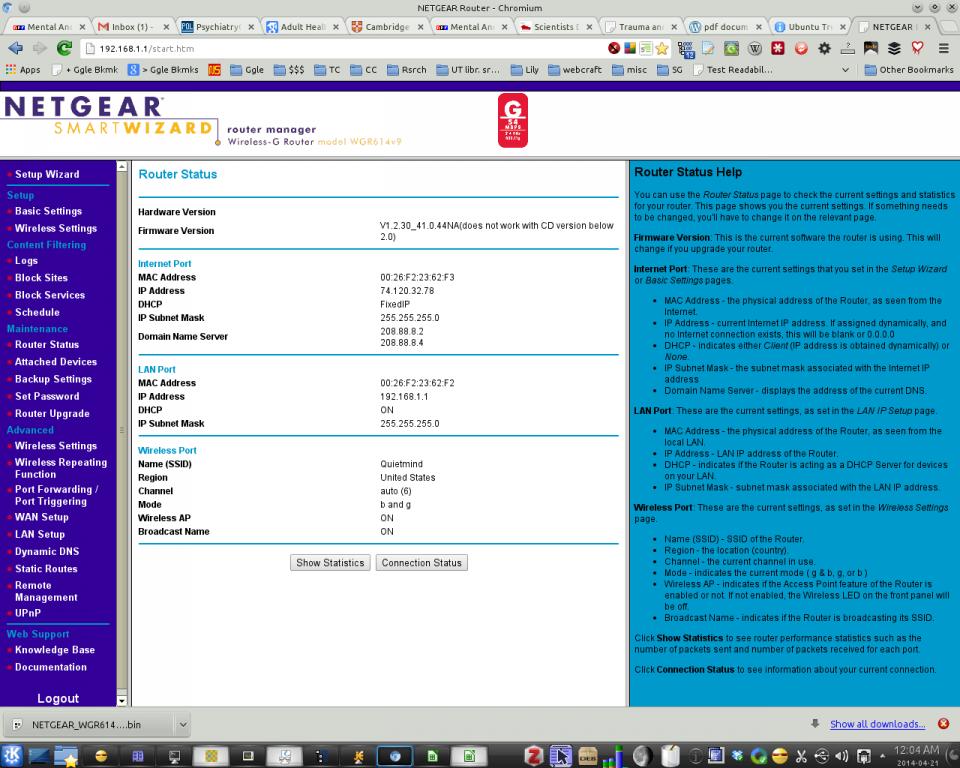

      Here's a screenshot of my router status page, in case that might be helpful in some way.
