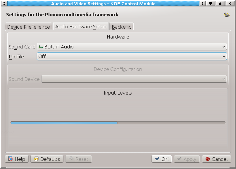

      2 - Playing around I found that I get all working when I only use the "Built In Audio Analog Stereo" settings for
      - Audio Playback
      - Audio Hardware and here additionally the Profile to Off.
      With these settings the vokum keys and the mute key work even when running the VLC player.

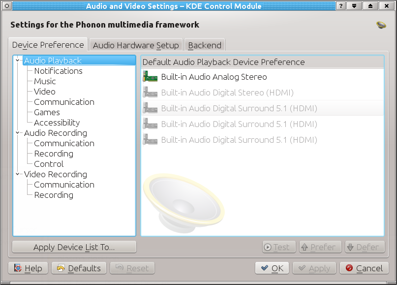

          Clicking Audio Setup lets following window pop up:
Name:	150105_17:02:57_Audio and Video Settings – KDE Control Module_001.png
          Here I can select the Built-in Audio Analog Stereo Device
          Digital device can only be selected if they are selected on the next screen in Profile

          Above screenshot show Profil selection to be OFF

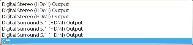

          Selection menu of Profile is shown below:
          In above screenshot the Profile is selected to be OFF; this allows me to hear the sound and use the 3 keys (mute, volumn up and down)

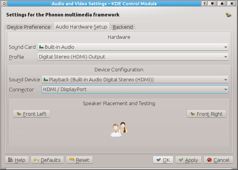

          Selection of Digital Stereo Profile result in the next screen -
Name:	150105_17:05:18_Audio and Video Settings – KDE Control Module_001.png

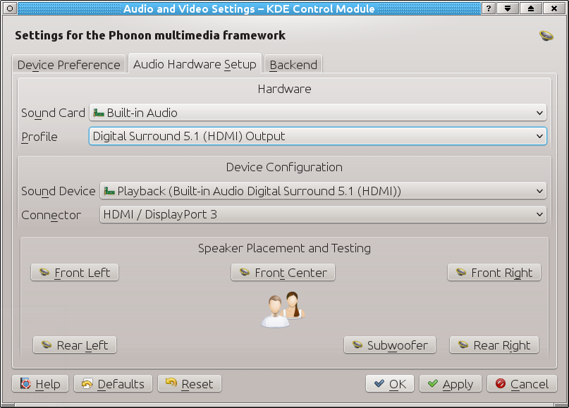

          Selection of Digital Suround Profile results in the next screen
Name:	150105_17:06:46_Audio and Video Settings – KDE Control Module_001.png
          Selecting either Digital Stereo or Digital Suround Profile does not allow to hear a sound.
