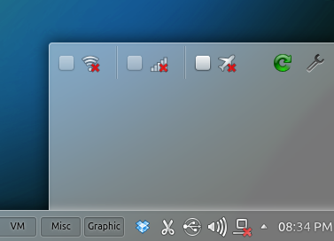

        your "ifconfig" shows the card as up,just no address assigned to it.
        if you click the network manager icon do you see the possible connection in the list and a button to connect ?
          Attached is what I see. I see no button to connect it anywhere.

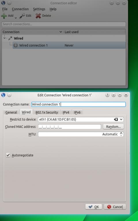

            Vinny:
            In the meantime, I tried a few other things.
            I deleted all connections, and then re created a new wired connection, selecting eth1 as the 'restrict to' device, and then rebooted.
            This time, the NIC status lights on the rear panel were lit during the POST up to and including a disk check. As soon as the GUI began to load, and right after the system 'beep', the NIC lights went out. No network connection.
            I then tried deleting all the connections again, and I left them deleted, hoping that the connection would be created on the next boot. Nope. No connection information, network status box in the lower right screen is still blank with all options with a red 'x' over them. No network connection.
            Frank.
