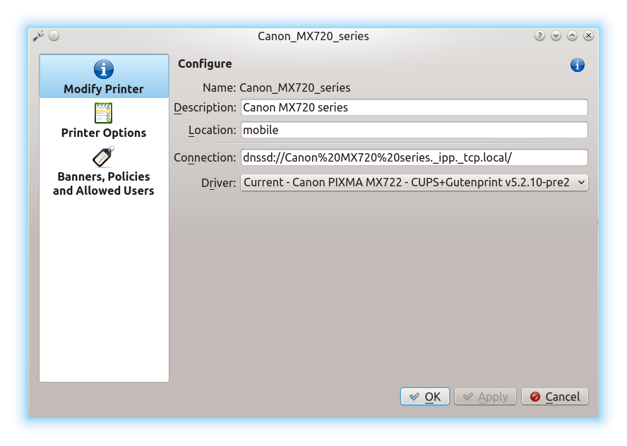

    Just bought a Canon Pixma MX722 printer for the trailer. I checked, and it has LInux support from Canon. I did not use the driver that I just linked to, as the Canon USA site, when it detects my Linux system, tells me that the driver may be included with my distro. It is -- on my 14.04 machine. A somewhat lesser numbered driver is included with this netbook that I am using now, which has 12.10 on it.
    Both machines see the wirelessly connected Canon printer. Both recommend a driver. Both allow me to install the driver, and both allow me to try to print a test page. Both show the progress of the print, to the 100% mark. Neither machine will actually cause the Canon to actually output a page, however. The data stream appears to go to 'bit heaven', and the printer applet reports that it is waiting for the printer to finish. The printer never finishes. It doesn't even start.
    Suggestions?
    Frank.
    PS: The attached screenshot is from my 14.04 machine.
    PPS: The canon prints fine wirelessly from my Android phone using the PrinterShare app. No network issues here. Everything works except my Linux boxes.

              Have you gone into CUPS and checked if the printer is set to be shared?
              Slava Ukraini! 🇺🇦
                Snowhog:
                No, I haven't checked. But I know that when setting it up, I specifically did NOT share it, as I often get duplicate instances of it on the network if I do. Is this wrong?
                OK, apparently, it is wrong....
                I used CUPS to set sharing to 'on', and now it works.

                  Snowhog:
                  Well, it works, so I am marking this 'solved'.
                  It works as it should on my 14.04 machine with the correct MX722 driver selected from the list that Kubuntu offers when setting up the printer. I didn't have to install anything extra.
                  The driver is amazingly complete, and it offers a plethora of settings that can be tweaked in the 'options' section of the print dialogs, from resolution to color model to saturation, to individual color intensities. There is a LOT there. Kudos to Canon for the Linux support.
                  It still does not work on my 12.10 machine, which only has the MX710 driver available, even after enabling sharing in CUPS. I could probably download and install the updated driver from Canon at the link I put in the first message, but this machine is due for a system upgrade anyway, so I'll just do that. 14.04 has more advantages than just newer printer drivers. I'm just waiting for the first point release before rolling it out onto my other machines.
